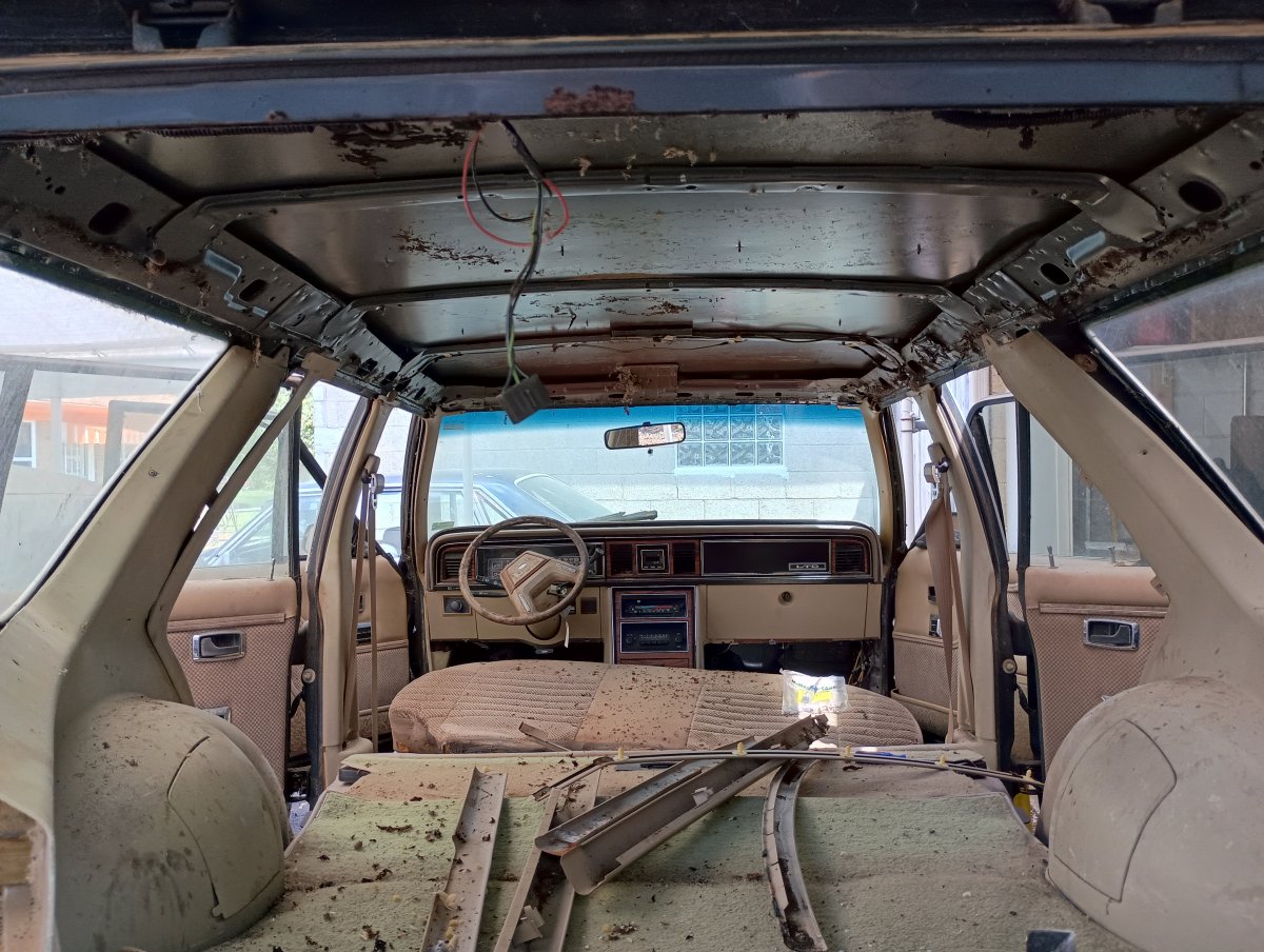

The throttle pedal and the DataLink Connector are at the dash, but the rest (Fuel and emissions) is at the rear. That means I needed to first tackle the nasty bit of removing the interior and headliner, as I knew it was all going to be gross.
I started to get the headliner out first, because I knew it was going to make a mess.
I was right.

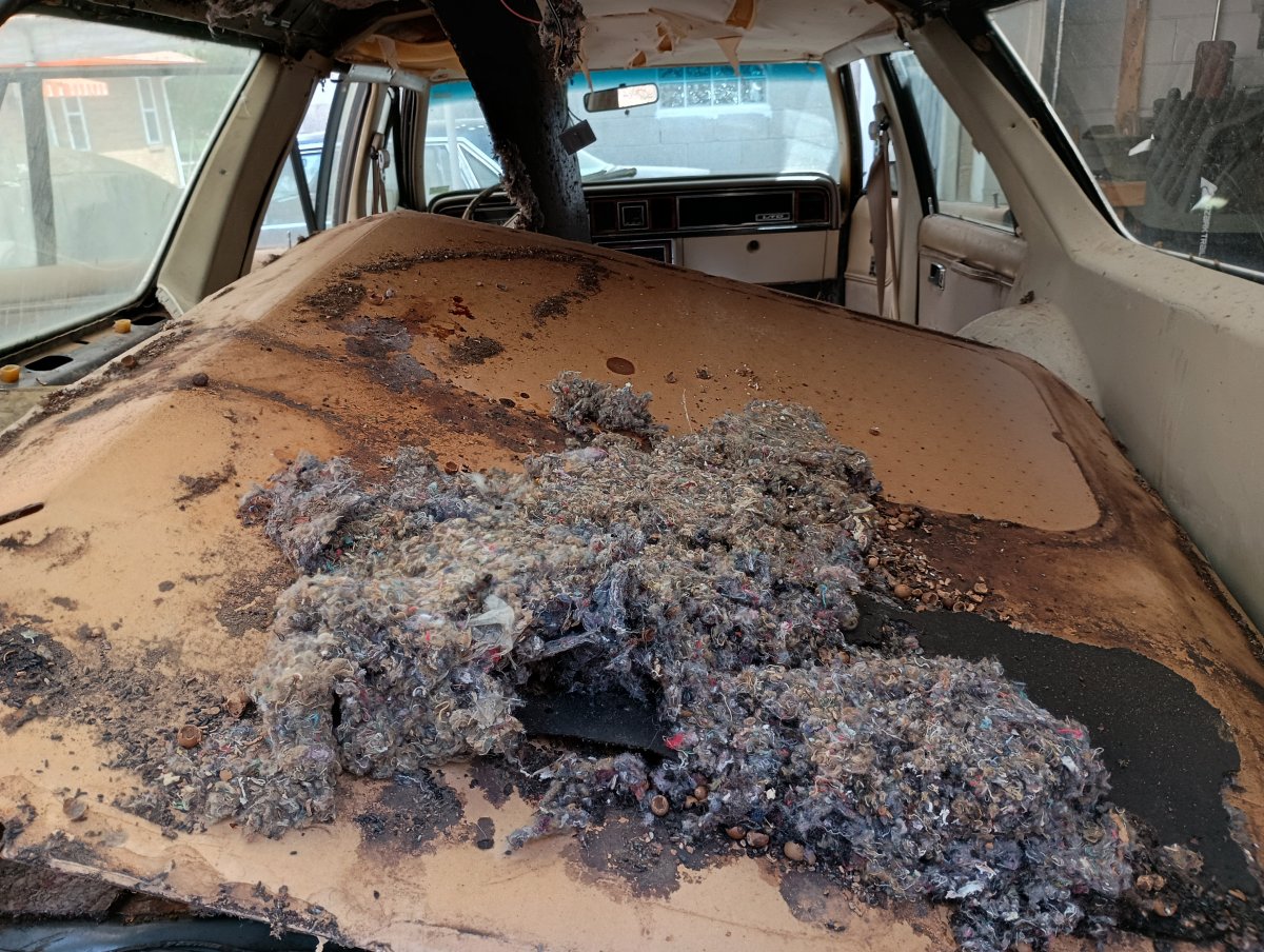

So much mouse poop. :yuck:

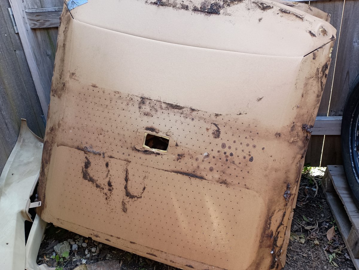

I'll be able to reuse the front board, but the rear one I'll probably have to make a replacement out of ABS sheet. The mouse nests were worse back there.

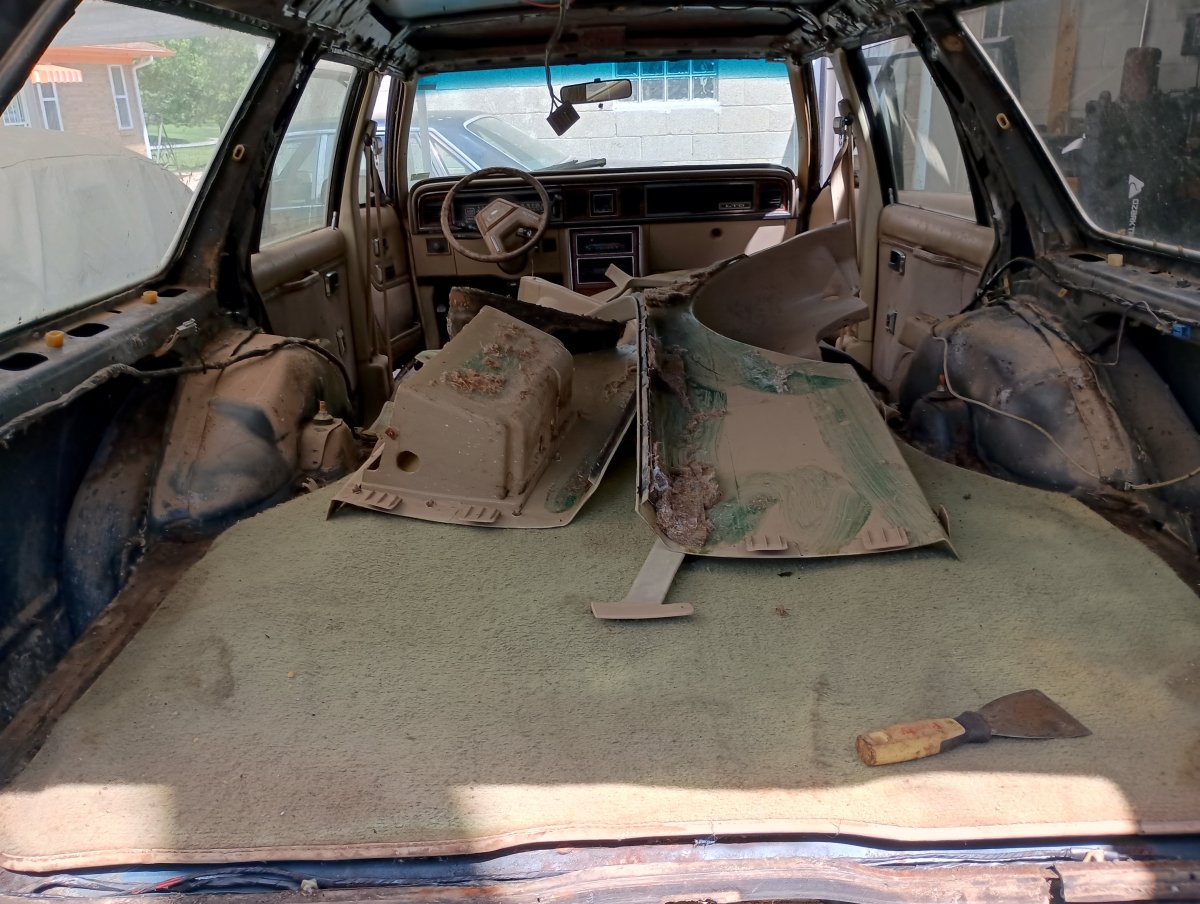

After that, I pulled out the rest of the trunk area panels and the rear seat.
It's amazing how much dust/dirt is on EVERYTHING inside this car behind all of the panels. Gonna take some time just to clean that all up.

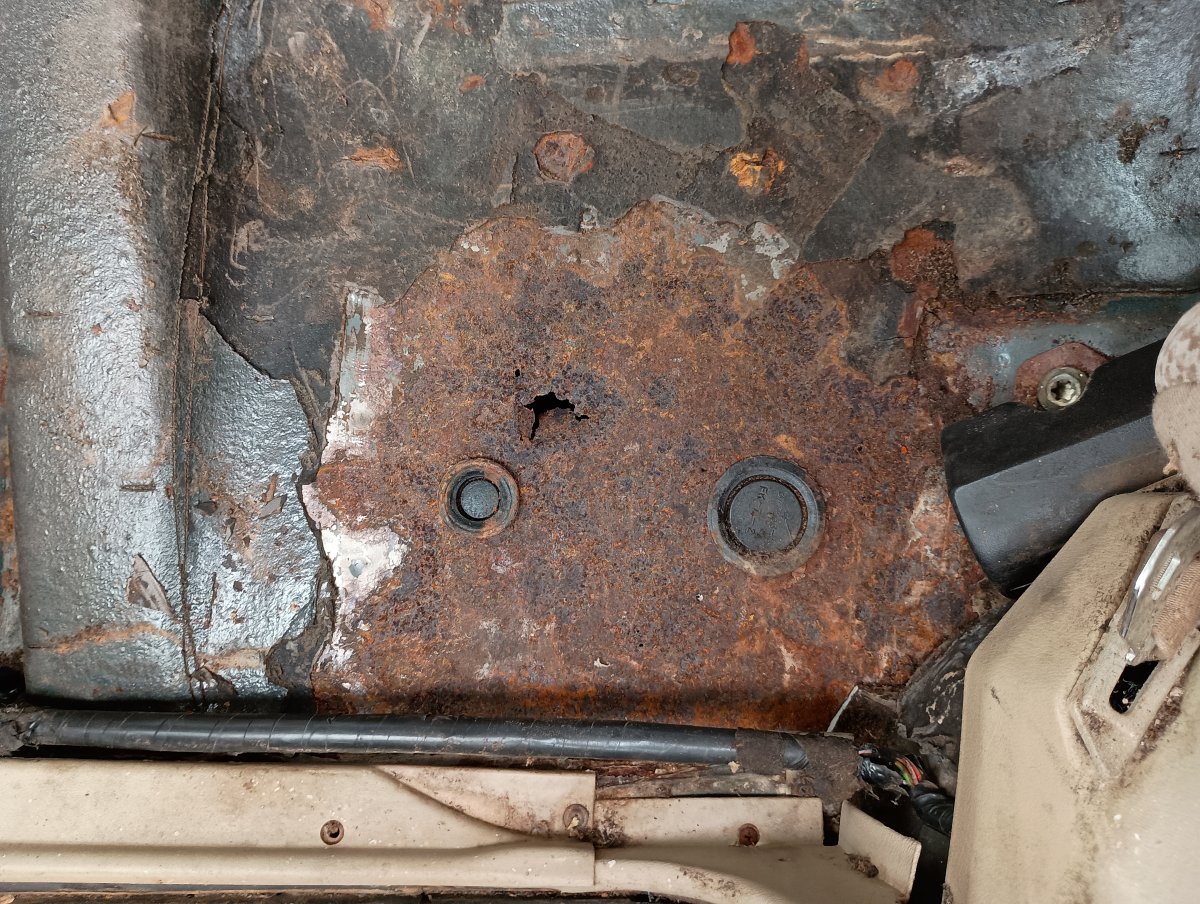

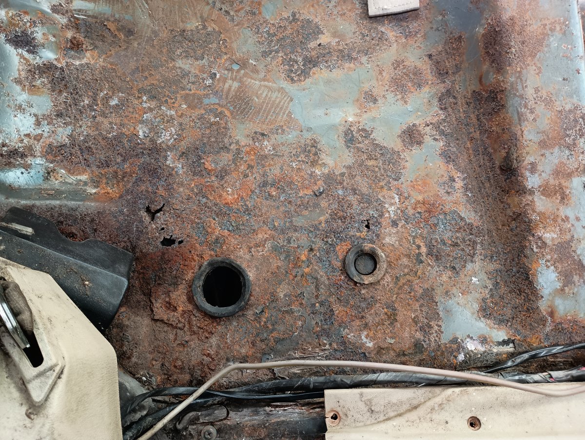

I did unfortunately find some soft spots in the floor under the rear seat base.
Kind of not surprised, as there was water ingress due to door strikers not having bushings on them.  Should be an easy repair, though.
Both lower rear quarter panel areas behind the rear wheels was also full of mouse house stuff. No corrosion, though.
I took all of this out, as I needed to trace the stock FP wiring back and de what I needed to do for the new stuff.
