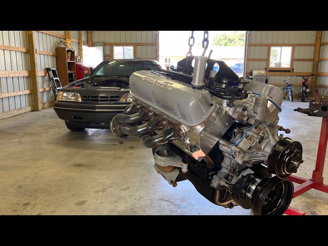

It’s been a long time coming (like 20 years of dreaming), but I just completed an engine rebuild on my 5.0.  It’s the original block with .30 over Wiseco forged pistons, forged rods, stock crank, and Trickflow 11R 170cc heads.  It also has a Trickflow street burner intake, MAF conversion, and TFS stage 1 cam.  Should really add some fun to how it drives.  It was a fun build, but very drawn out due to all the parts availability issues these days.  The machine shop guy couldn’t believe how little wear/clean my 200k mile short block was.  If it didn’t start eating it’s cam bearings, it might still be trucking along, lol.  Ford powa!
I’ve made a couple of really amateur YouTube videos of how it came along if you want to check it out.
https://youtu.be/w_8ThGMPmTI
https://youtu.be/ovtSWvmT9lI
