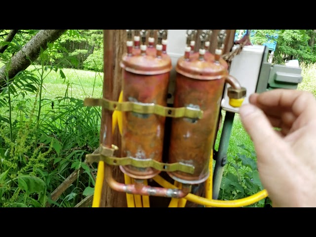

here is the youtube link with the testing done live
this was done in a controlled manner, there's no reason to use anything else after you see this.....
my lessons learned are............
use 25% phos acid most times as its more effective than using 50/50.
I guess it has something to do with chemistry class.  also,, the white ish looking residue apparently is 100% paintable from what i have seen by others.,, as well is the black residue.
its almost like a primer layer self built upon the metal.
my channel............
https://www.youtube.com/watch?v=ddUrjy-_UYk
