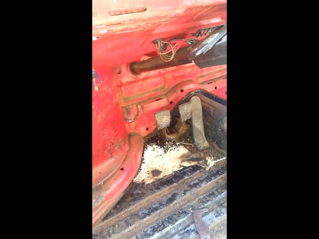

we've got about 2300$ in the interior rework all in boxes ready to install but have body work to do.
its not all that bad but the typical day at the office for any VW fan.  this is the wifes daily driver we are working on.
once the inside is done along with interior color change, i will move on to exterior painting.
here is my youtube channel... on this car .
If and when you get to part 6,, i have a couple tech questions that are going to need addressed prior to wrapping up the inside.
i think with a full body rubber kit (thats what they call it) for 600$ and paint stuff at around 500$.. that should call it a wrap for this shade tree mech resto work.
I am taking my first crack at phosphoric acid being used as a rust remover so i will be testing that out and posting the results.
The price point on "food grade" phosphoric acid is much better and since we are going to need to reduce it,,, i may end up with 2 gallons of somewhat safe to handle rust dissolving agent.

so,, we are now at a point of reverse... installing all the new things to complete the improvements and resto of lots of areas.
what i am currently stuck on is the rear window install... i mean stuck... its like the new rubber seal is just too beefy to allow the window to fully seat.  we may have to go to the germany source for the seal instead of the one from airheads.
we are on attempt 4 ,, even with vasaline on the car frame and on the glass. the rubber is flaring "out" around the window.
we are up to 33 vids so far and i will post a vid of the problem we are currently having.
