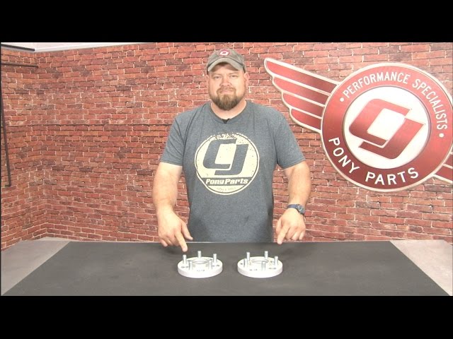

the 87-93 Fox Mustang 8.8 is approximately 0.75" narrower per side than a 94-98 SN95 8.8 rear end.  The SN95 is the closest to the Turbo Coupe 8.8 in width hence the reason all that desire to move to five lug get the SN95 rear end.  With that being said and the fact that you want to remain 4 lug the 8.8 out of the Fox Mustang you have located will be right at 0.75" per side narrower than the rear end you currently have.  Spacers of this thickness will need to be like the following however these are for five lug but you get the idea:
https://www.youtube.com/watch?v=avTdeSMMXyk
The reason for these is that you do not have enough wheel stud length on the 8.8 to accommodate 0.75" of slip on spacer.  You are better off looking for a 87-88 Turbo Coupe rear end (getting harder and harder to find), rebuild what you have, or buy the Fox Mustang 8.8 and buy two wheels that match what you have and get them with the right offset and back spacing to move the wheel out 0.75".

Alright thanks so much, I think I'll just go with the 86 4 lug 8.8 and find some wheel spacers that'll work. Thanks so much though
