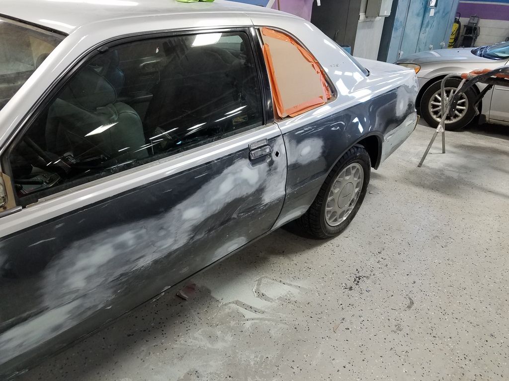

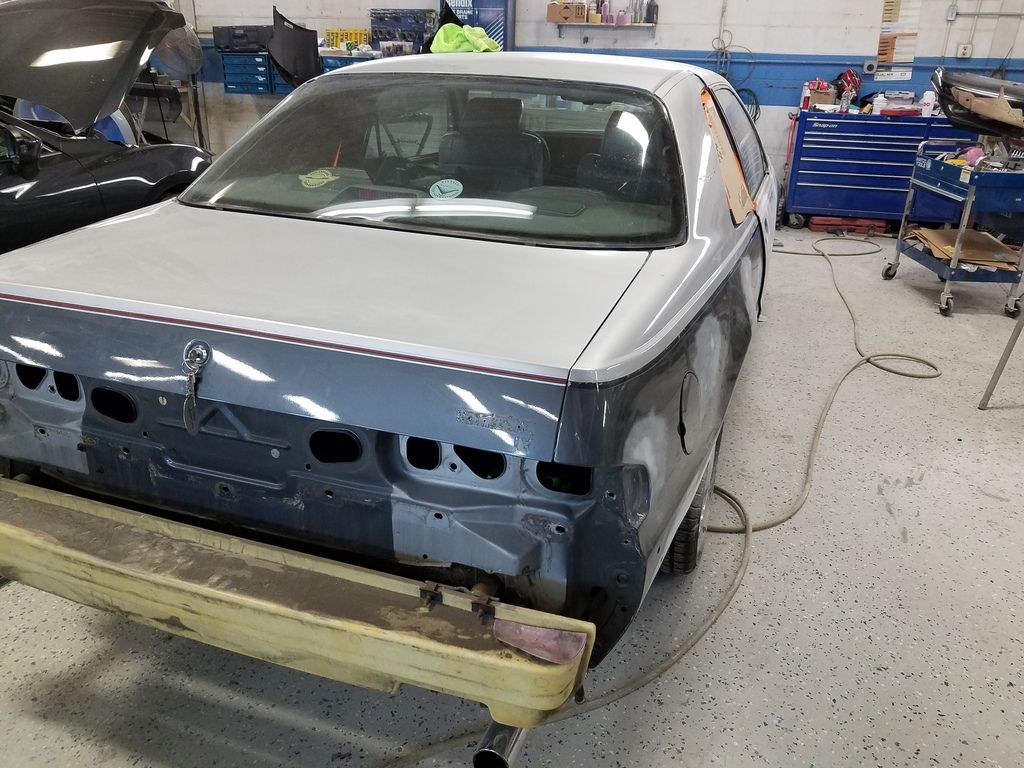

Well a week in and all the dents and rust spots are gone. The rust where the quarter panel met the rocker wasn't bad. The body guy was able to grind it down to bare metal and there were no holes. It didn't need a patch panel. Just etch primer and sealer. The driver's door needs to have the hinge pins changed and to be aligned, along with a different driver side fender (the stock one had rust caused by dirt and water trapped by the sound insulation behind the fender liner). So in the next couple days the body should be down to metal and primed. The goal is to get the first layer of paint down by the end of this week and finish everything up sometime the following week.
On a note you can see how much sun fade (even after lots of polish and wax) the paint had after 29 years. The gray that was below the tape stripe and behind the tail lights/rear bumper is darker than the paint that was exposed to the sun.

I still can't believe you're doing this. I have some dents here and there but eventually I'll have someone PDR them. I just can't bring myself to cover up factory paint unless it's absolutely necessary!
Crazy how a perfect Cali car can still suffer from that quarter-to-rocker rust. Only a Fox would do that :rollin:
It's definitely gonna be amazing when finished.

Yeah that quarter to rocker rust is probably the result of the seam sealer breaking down and water getting in the area. It's gone now.
The factory paint on the car looks better in pictures than it does up close. In the last year or two the clear coat on the roof above the passenger door and the middle of the trunk lid was starting to haze. It only took about 27 years for the infamous clear coat haze to start. Lots of wax and garaging kept it away for much longer than usual.
Also having 3 cars around with almost perfect paint was starting to make the Thunderbird look its age. Can't have that ;).

All those white circles are dents and dings. I could look down the door at certain angles and see them all. It used to drive me nuts :hick:

Well it's stripped. The guy assigned to paint the car hurt his back on Wednesday, right after he pulled both fenders off to e-coat the back of them before aligning everything. So forward of the doors there's nothing but the hood right now. The guy should hopefully be back Monday. I'm hoping it's done this coming Friday  (a week from today) but I'm probably being optimistic. I'd rather it take longer than antited and look perfect vs. a rushed, half ass job.
Even when I get the car back it's not done. I have to put the sail panels, door panels, and all the exterior trim and moldings back on...
