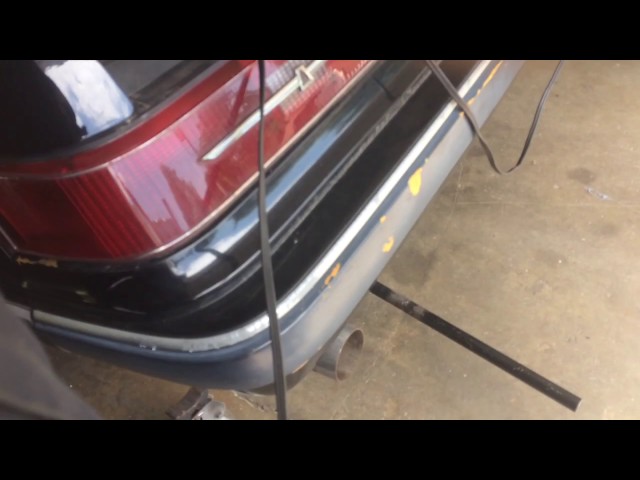

I hit the key and she fired up for the first time.
https://www.youtube.com/watch?v=6aHxjw57lAg
I got the car warmed up, leak checked, adjusted electric fan settings,set fuel pressure and started playing with fuel and timing maps. I shut car down to go cool off and have lunch while my buddy was on his way from Canada to come see his car run for the first time. Once he got here the can wouldnt start again. Fuel pumps would prime but wouldnt turn back on after cranking the car over...
I spent the last three days pulling my hair out trying to figure out what happened. The dam thing fired right up and ran for 20mins that first time then never again and I was stumped.  After talking with numerous people and checking 100 things I finally found that the 12v keyed power source I used from the chassis harness to the Ron Francis engine harness would show 12v with key on but after car was cranked it dropped to 8-7v and stayed there. Not sure why or what this wire is {in the 6 pin grey plug near brake booster} but once I swapped that wire to a different 12v keyed source the car fired right up and moved under its own power for the first time since my buddy bought it.
https://www.youtube.com/watch?v=SxOlhu8rQDY&t=10s
