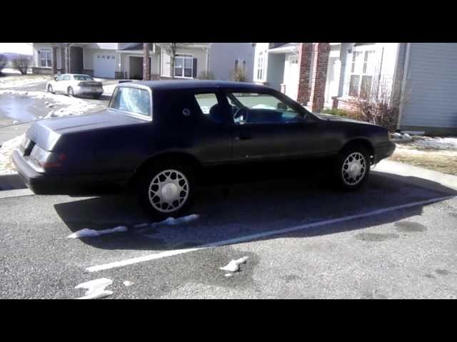

I made my own exhaust for my 2.3T swapped Cougar.  I used a Stinger performance 3" downpipe, a Dynomax race bullet, a 45 degree bend and a few short pieces of pipe.  Works great and was easy to do.  It exits in front of the rear tire and looks like this...
Sounds like this...
