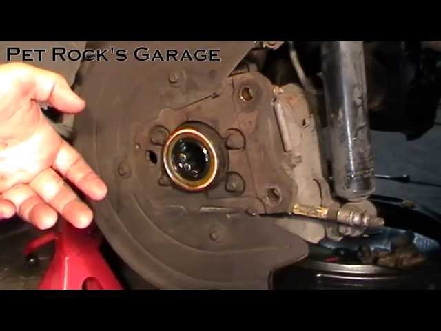

Where is the rear wheel bearing located on my 86 Cougar?  Is it behind the hub?
Axle bearings
Behind the axle.
You have to drain fluid and pull the c-clips in the diff before you can pull the axle. Then you need a tool to remove and press in the new one into the axle tube.
Axle bearings
Pretty decent video showing how to replace the rear axle bearing and seal.
https://www.youtube.com/watch?v=VXEqzMVRRso
