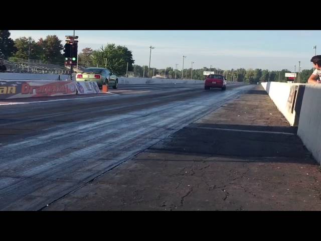

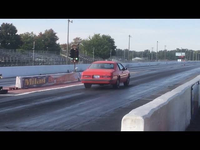

Well I took my car to Milan Dragway yesterday to see what it would do. I had a blast and it didnt set the world on fire but I am real happy with its first outing!
Crazy to think how fast I put this car together and how well it turned out. I showed up at the track with all of 66 miles on the car. Brand new motor,new T5, new tires,new braking system,new suspension and a brand new MircoSquirt computer with very minimal tuning time on it.
First pass off the trailer went about how I thought... blew the tires off, pedal, short shift around 5500 and ran a 14.52 at 97
https://www.youtube.com/watch?v=rshagmpSRVY
Logs showed it was real lean everywhere so I added some fuel and tried again. Still tryin to figure out the launch it went 14.00 @ 100 after a few horrible launches
https://www.youtube.com/watch?v=5ofMynz5Pp8
Added more fuel and launched it real easy it pulled a 2.09 60ft and ran a 13.93 @ almost 102
https://www.youtube.com/watch?v=ClV8He6lFkc
After that there was a string of a few more 13.90s but with more wheel spin it wasnt going to get any better. I data logged every pass and made some adjustments this morning that really made a big difference in the seat of the pants.
My biggest problem is the car is right in the middle of the wrong gear combo. With 3.55 gears my shift light was coming on about 1200ft in 3rd and leaving it in 3rd I would cross the line doing 101-102 at 6200rpm, if I shifted to 4th it would drop 3mph. So I think I might drop back to a 3.27 gear so I can lower rpm in 3rd across the stripe.

Boy, looks like you need some tars... :hick:  Guessing you have std tires??? A set of drag radials would get it out of the hole in under 2.00sec...
If you don't improve traction the taller gears will make it more difficult to launch... You can play with tire height, easier than changing gears...
BTW, congrats 102 is a scootin', guessing you've already found more in the tune...
