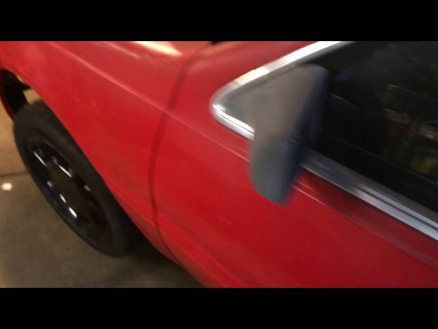

Well I now have about 1000 miles on it and a couple trips to the drag strip and Im absolutely in love with this car! Its such a blast to drive and Im getting all kinds of random people making nice comments about it at the gas station,store,etc...
Went to the track this weekend and the tune is as dialed in as it can be. Runs great, super strong, great mileage and so far its pulled a bunch of 13.30s at 102 mph which i think is great for a basically stock 302.
https://www.youtube.com/watch?v=zLsjxkHvCzQ&feature=em-upload_owner
So today starts the next step. Getting it ready for paint! Im doing as much prep as I can for my painter but its going to be a more budget minded job than a killer show quality job since I plan to drive the wheels off it.
