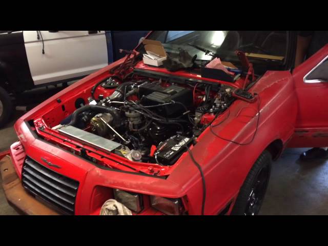

Its alive!!
https://www.youtube.com/watch?v=JSEJ52SedIk
Had to replace the inlet fitting on my 255 Walbro and the fitting on the line since it was the most amazing hack job I have seen yet..New tank is in. New in tank pump was longer than the original so I had to cut up,shorten and reweld the hanger on the sending unit so the pump didnt bottom out in the tank. I bled the brakes and finished everything under rear of car. I made a little 3" dump for my tailpipe and just need to build the pipes between the collectors and the Y pipe.
Sooo, now its time to wire the gauges, fix my water pump leak,little more interior clean up, alignment and then off to paint!
