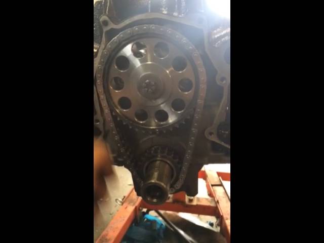

But here the best one. I bought a new DynaGear steel timing set off some speedshop on Ebay for $75 a few weeks ago and finally got around to installing it yesterday. Check this out..
https://www.youtube.com/watch?v=mHwAFSxVCCk
The hole for the pin was to big so the gear rocked on the cam.The key way slots were to big also and I swear the chain had an extra link in it.Total junk. Ran down to Orielys and grabbed a cheap off the shelf set and its good to go now.
https://www.youtube.com/watch?v=Hg4965uDv_8
