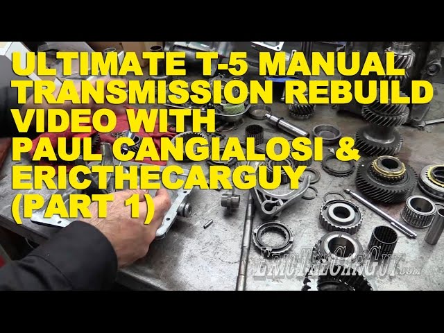

Eric the car guy just did an excellent tear down video on a sn-95 t-5. It actually really doesn't look like rebuilding a t-5 would be all that hard.
https://youtu.be/XREsRG9Y1mU
They aren't that bad, 20+ years ago, I repl syncro's in a '87 4cyl and rebuilt a '86 5.0 twice(I busted it again after 1st rebuild, used stronger gear set 2nd time)... Nothing really magical or mysterious about them, driving the roll pin out/in the shifter detent assembly is as much of a pain as anything...
