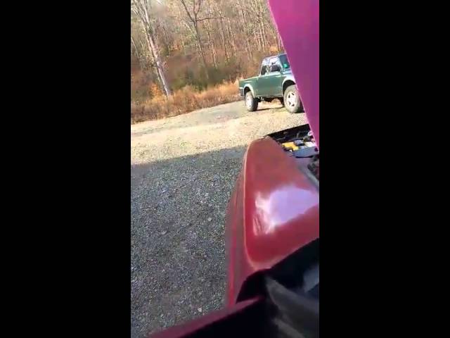

A few days ago I had my oil changed since June (about 6 months) and the coolant topped off at the garage that I had been going to since I had gotten the car over summer.
Before having the oil changed a few days ago the car had sounded great. The ler roared, and the engine sang. No odd sounds. Over thanksgiving, my brother and I removed the silencer, and the car sounded even better.
The day following the oil change two or three days ago, I noticed more of an "air rushing" sound, and less of a sound from the exhaust. taking off in 1st sounds like a bunch bag pipes... yeah, thats right,.... bag pipes.
Today, on this sunny and warm December day in CT, I drove the car hard and discovered a sequenced sound of chirping/whining over 4000 rpms (on/off, on/off at a relatively high pace).
I thought maybe it's valves doing what they do, but I also got a series of clicking/vibration when I got home and parked the car.
I am horrified of what the hell has happened because I can't continue putting money into this car with school and all.
Perhaps you guys can persuade me to stay positive...... See video.
*I am a "spirited" driver, and so I do drive hard on occasion, but I never redline. I almost always keep the revs below 5500.
https://www.youtube.com/watch?v=LDLyPwfs6b4&feature=youtu.be

Have you tried taking off the belt and running the car to see if the noise still exists? It's probably coming from an engine driven accessory.

I had my twin rev the motor. It sounds like a lower accessory.
Is it worth putting on a new belt tomorrow to test? I have an unopened one in the trunk, I think my stepdad and I should be able to do that with minimal chance of shag up...
New Screeching/chirping sound shortly after oil change and fluid top off. WTF.
Take the belt off and move each pulley by hand. You might be able to feel some resistance or a grinding feeling on the pulleys.

I'm definitely going to do the spray test and see if I can diagnose the serpentine belt whine. I don't want to get worse; it's also annoying.

My stepdad again says I'm neurotic and shouldn't obsess over it. I think coolant was spilled at Mike's garage or the clutchless AC pulley or tensioner pulley is going. Everything else looks and sounds straight.

Any news on this? I was told once to be careful not to get antifreeze on a serp belt and if I did to thoroughly wash it off. The water (if a 50-50 mixture) will evaporate but the glycol will not. It will then dry, crystallize and never go away, causing slippage/screeching of the belt.

The car continues to chirp/squeal around 3500 rpm's as it did when it started after the oil/coolant top off. It's sounds like a blow off valve or something silly when gunning high  in the rev band. I don't know what it is. I'm assuming it's the beaten-to-death de-clutched AC pulley or some other pulley. I did the "spray bottle" test, and had no change in sound. So i assume it's hardware, not belt.
I also did some research about pvc hoses popping out that go in and out of the intake manifold, but haven't found any videos re-creating the sound my car makes.
A kid on one of the Cougar forums on facebook told me he had the same issue with his XR7, and that it was the tension pulley.
Either way, I'll get the pulleys inspected and maybe replaced early this summer, maybe at the Ford Dealership. I also want to get a fresh AC delete pulley to have mounted over summer so I can get rid of the AC .
