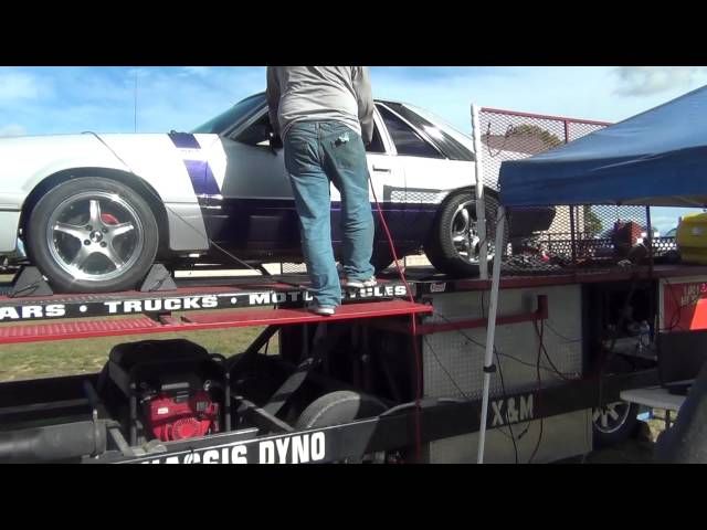

Check out this guy. His combo started out where you will probably be and is now at 329rwhp with untouched GT40p's and an Explorer intake. He's also mass air and tuned with Moates Quarter horse. I think both moates and tweecer both rely on having mass air just in case you want to dabble in tuning. Something else to think about.
