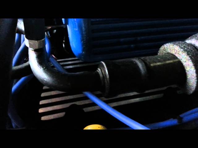

Set the fuel pressure to 39-40psi with the vacuum line disconnected and you should be good to go. I'm betting the low fuel pressure is what caused the popping and hesitation issues. The lower fuel pressure was probably making the car run a bit lean. I have 40psi of fuel pressure on my car with the vacuum line disconnected. I have a stock replacement Motorcraft fuel pressure regulator. The computer ends up tuning around any fuel pressure change above or below the stock 39-40psi setting. As far as roller rocker noise this is what my car sounds like. It's about 1/2 turn after zero lash with a 700rpm hot idle.
http://m.youtube.com/watch?v=ayd1Hc0TePc
Rocker adjustment....
Reply #43
YES!!! THAT noise sounds like mine right now. LOL. A LOT worse before I readjusted the rockers today. I was happy with it after the adjusting. Especially after the last week of crazy chatter. LOL.
