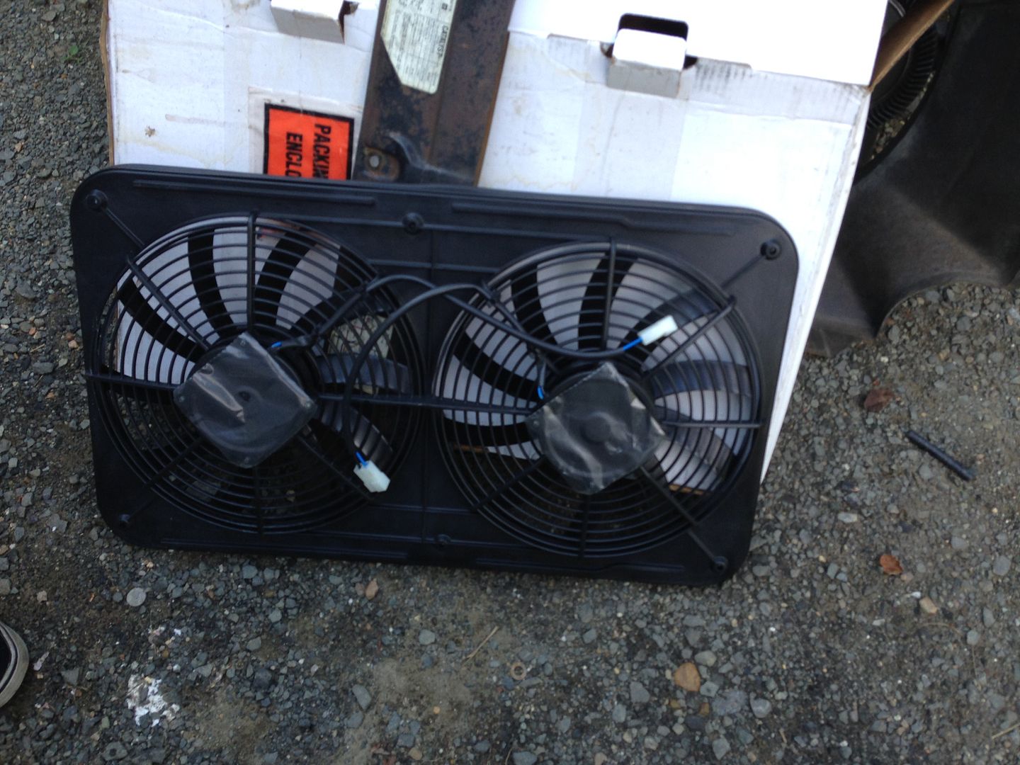

Build a fan system with redundancy. Never run a single fan setup and wire them to come on at different temps. Use 2 75AMP bosch relays one for each fan and a temp, sender for each fan and you problems are over. Clutch FANS are garbage and by the way can also fail. Especially aftermarket ones. No one uses clutch fans anymore. that is unless you have a 100 point car. Have a great evening.
Here is a setup i just finished for an early Camaro. I even made custom brackets to eliminate the ugly stock upper radiator plate. And whipped up some fancy mounting brackets as well. JR as usual painted them PORSCHE GRAY. The kid is impossible
But, that's soo much more money Tom! There are so many places where that money could be better spent! And the wiring, at this point in time if I get rid of the E fan I would only have ~5 wires in my engine bay (discounting headlight wiring and windshield wiper motor)! Down with the wires!

Tom, that looks really nice.  How did you tap those mounts to the fans, is it a metal case?

NOPE they came with nut-certs built right in to the housing and they are 1/4 20 threads. Jegs the fans were actually cheap and work great. The secret is not to use a garbage controller and in my experience they are all garbage. Those 75 Amp Bosch relays are the ticket. They hold up very nicely and those fans do not draw anywhere near 75 amps. remember removing a clutch fan will gain you 15 Ponies. remember there are all kinds of clutch fan assemblies. Thermatic viscus and friction. Make sure you get a thermatic and that will set you back a bunch of coin. And if you have a working AC system better get the one recommended or you will be chasing down an issue of running hot in traffic. If you want to go cheap and dirty get a standard fan and dump the clutch completely. Once again no one uses a clutch fan anymore . It robs to much HP.  Have a great evening guys.
Question?? You must already have an electric fan so why change it if it works for you. All you need is a good BOSCH relay and a thermal switch.
