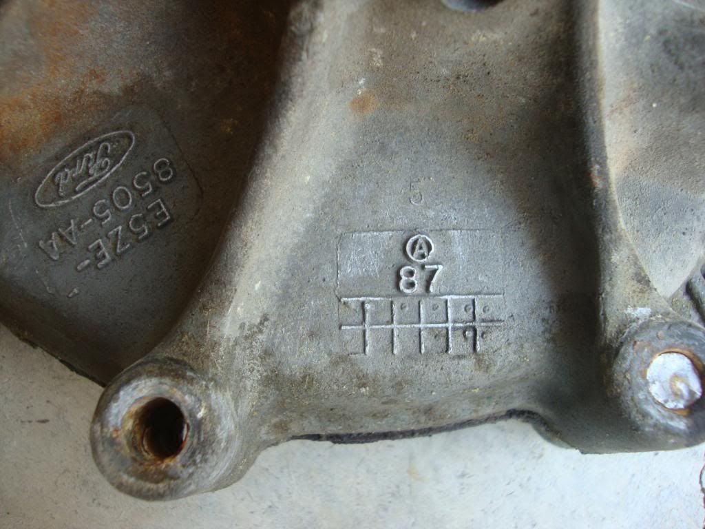

Water pump looks original.  I assume the "87" is the year of manufacture..

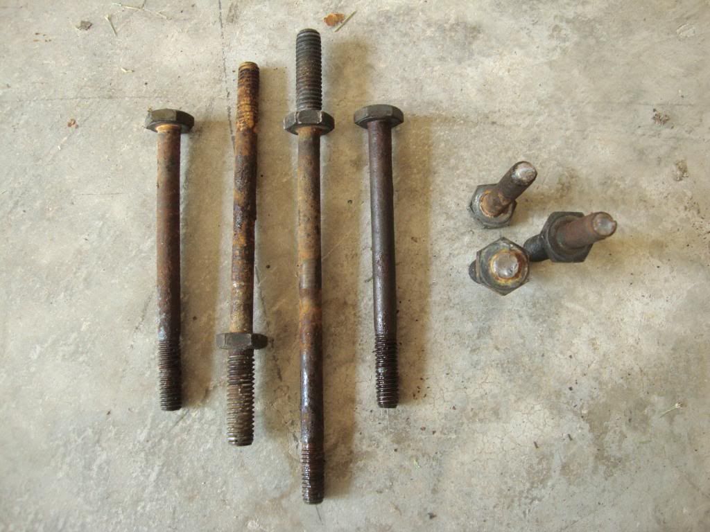

And here they are....guilty as charged!

so did you get them out ?[/QUOTE]
Yes and no.  The top bolts were actually seized in the timing chain cover and remain there.  Everything in the block backed out cleanly.  The source of the problem is that Ford used a water-pump stud as the main battery ground.  From High School chemistry, electrolysis occurs when battery current flows through the water pump cover, and then through all of the bolts.  That's why the studs/bolts fuse in that area.  People that rebuild 5.0's for a living know very well about all of the broken studs/bolts in the block for the water pump and the "eaten up" water pump covers.
