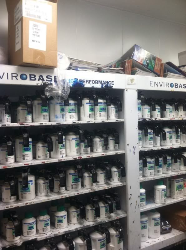

Once again B is laughing at me.  I was just chiming in. From what i know about painting single stage is not something i want on my car. Just saying. With that carry on B always a PLEASURE. Have a nice DAY as usual!!
As i am actually banned from the paint shop by JR. I really dont know why. Here is the stuff he uses. just saying. Once again i am not a painter. I just let JR do his thing and i pay the bills. I know he goes to training where they actually measure the thickness of the material he lays down on a test panel. Either MB or RR paint Speaze or something like that. just saying that's all
