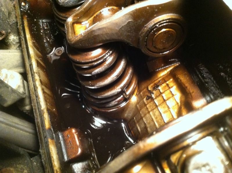

As usual there is no rest for the weary. A Chevy Astro van pulled in to the shop today and i could hear it from my office. IT WAS MISSING BIG TIME. Once again a new customer approached me and asked if i was RENZO? Thats me in the flesh i replied. The customer explained that he started his van this morning and it was running BAD!! With that i got out my scan tool and it verified cylinder 4 was the  culprit. With that i explained to the customer these engines pull rocker bolts out and it could be fixed rather easily. With that i got a signed repair order and pulled the valve cover. WOOPS what the HELL. No pulled bolts??? What was up. Well it turns out the valve spring snapped in two. Not uncommon on this engine but never the less RARE. So i got a new spring from the dealer filled the cylinder with air. The air was leaking out rather heavily so i felt the valve was bent. Installed the spring and fired it up after waiting an hour for the lifter to bleed down. NO DICE the little chevy had a bad miss. Turns out the valve was bent according to my leak down tester. So a call to the customer  that wants to fix the one head. So off the head comes and off to the chevy store for head bolts gaskets a valve and a full set of new springs. Check out the busted spring. NOT GOOD!!

I don't know how common that is, but it's rare for a 3.0L pushrod Ford.  Never the less, I had one come back 4 days after a tune-up and cam synchro with No.3 (back bank) Exhaust valve spring broken that same way.  It was a bit of a strange reach, but I put air on the hole and swapped it.  Still ran like balls, pulled it back down again and found I had missed the lifter with the pushrod and bent it.  I ended up swapping a valve spring that wasn't my fault and a pushrod that was, but I still made money and it rolled out running like a champ.

Things like that happen now and again. But this guy bent the VALVE. 4 hours  tair down. Not fun on this car. But that is LIFE in our business.
Funny FOE i have seen more and more valve spring failures lately. MINI COOPERS also break springs. What is going on with these springs. When i build performance engines i normally use dual springs for this reason other than more pressures DUEL DUTY AND GOOD INSURANCE. Comp Cam springs are notorious for failures. If a spring breaks the inside spring saves the day. On a hydraulic lifter motor the lifter will pump all the way up and bingo piston meets valve. NOT GOOD!!
