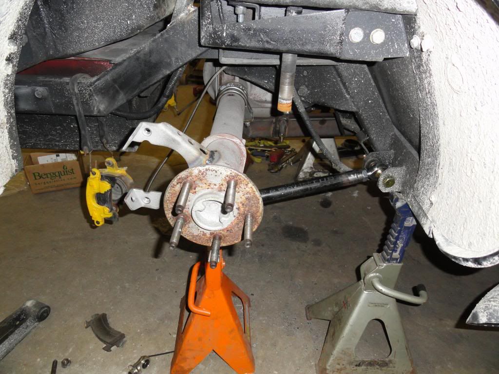

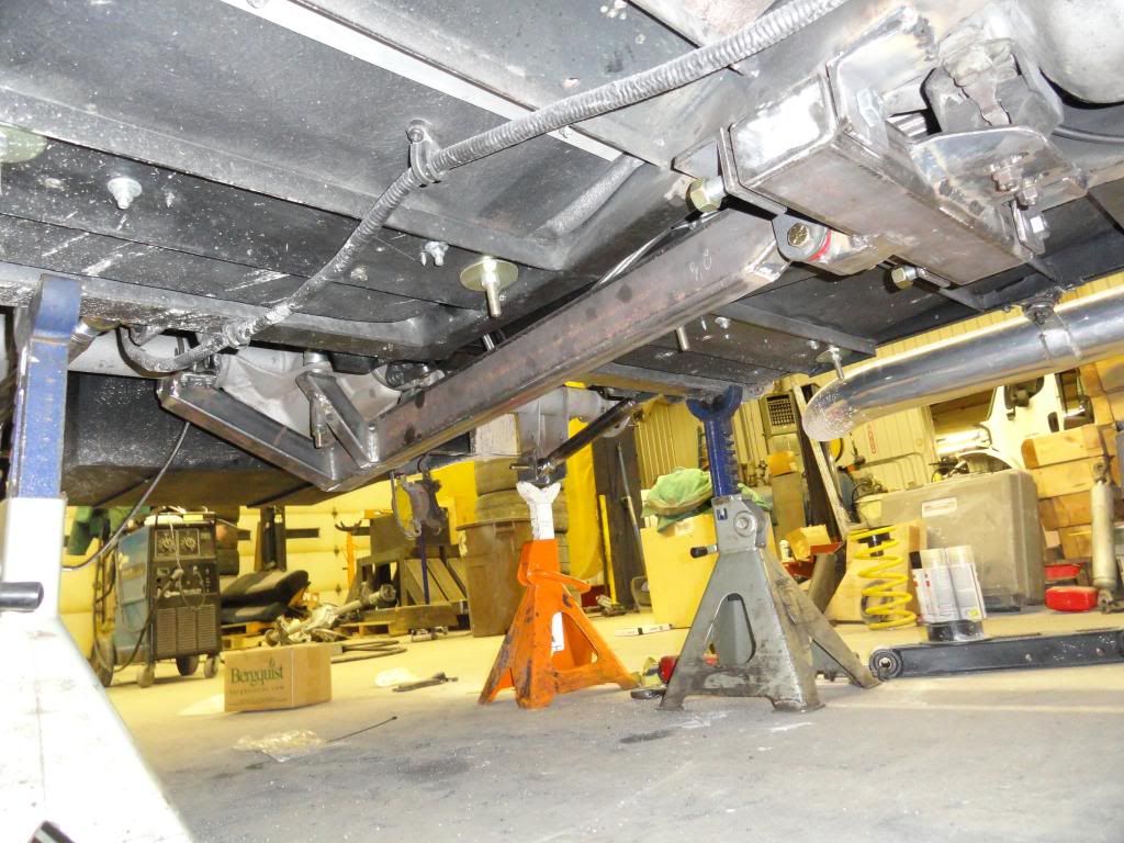

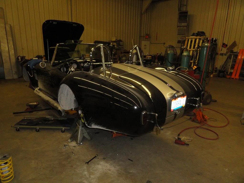

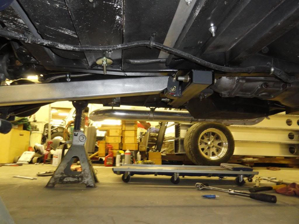

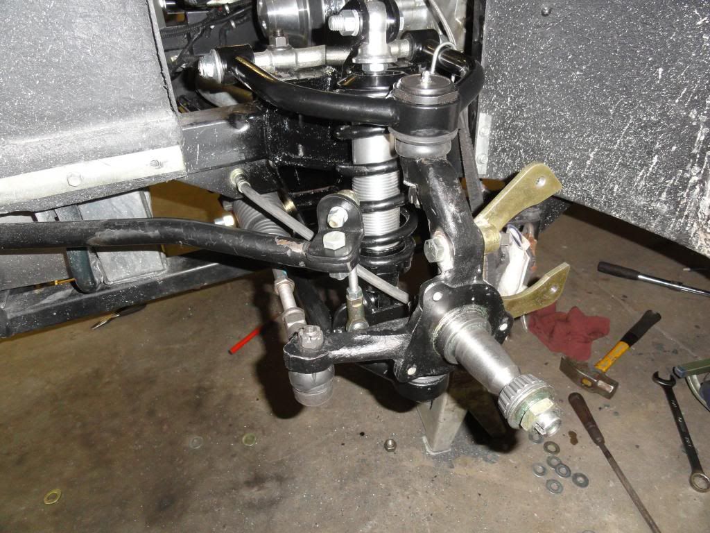

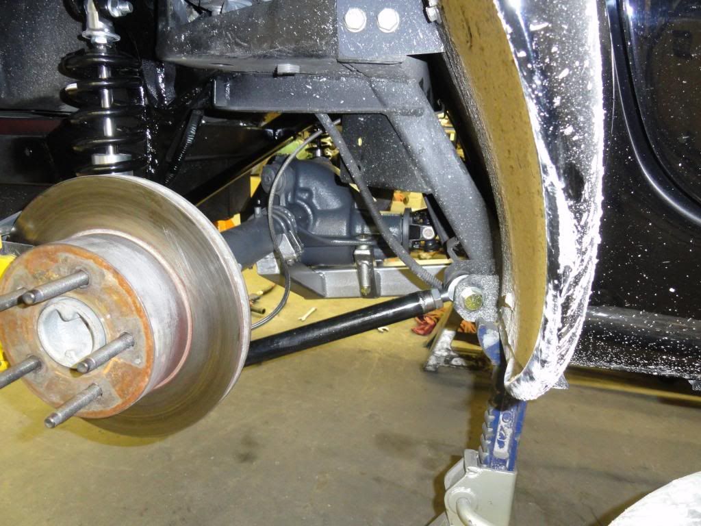

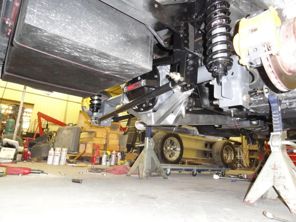

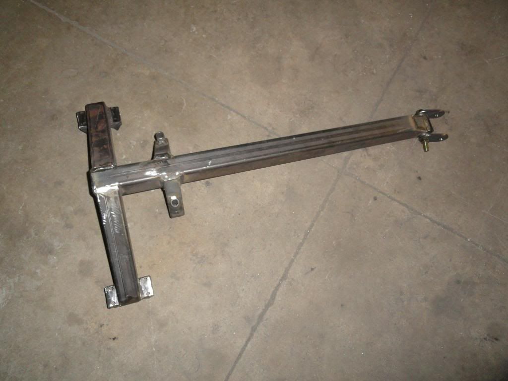

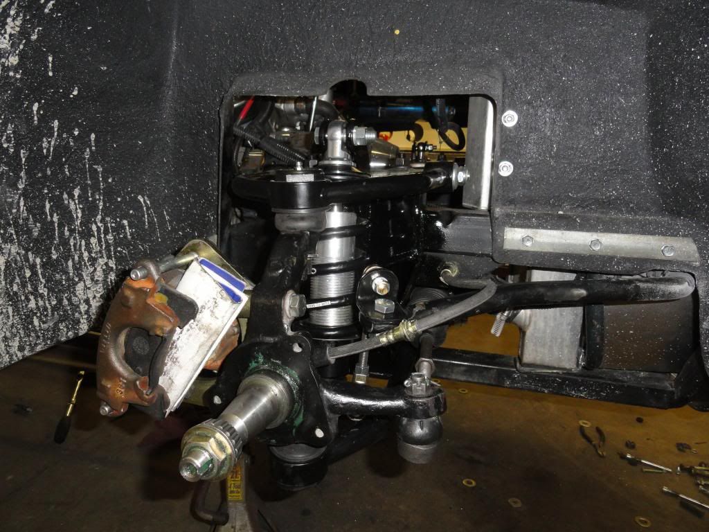

That takes us to where I get to put a new suspension under this car that actually works.  It pretty much had a mustang rear suspension under it but with really short lower control arms that I think bound the rear up so bad that it gave no warning at all.  So the upgrades are going to be a torque arm, panhard bar, coilovers, heim lower control arms, and tubular mustang II front control arms.  Its also getting an 8.8 axle instead of the 7.5 that was in it.

Meant to ask earlier, did the Cobra have poly bushings in the rear at all points? that will cause binding, probably more so with even shorter c/a lengths.
Cobra suspension upgrade - not my car though

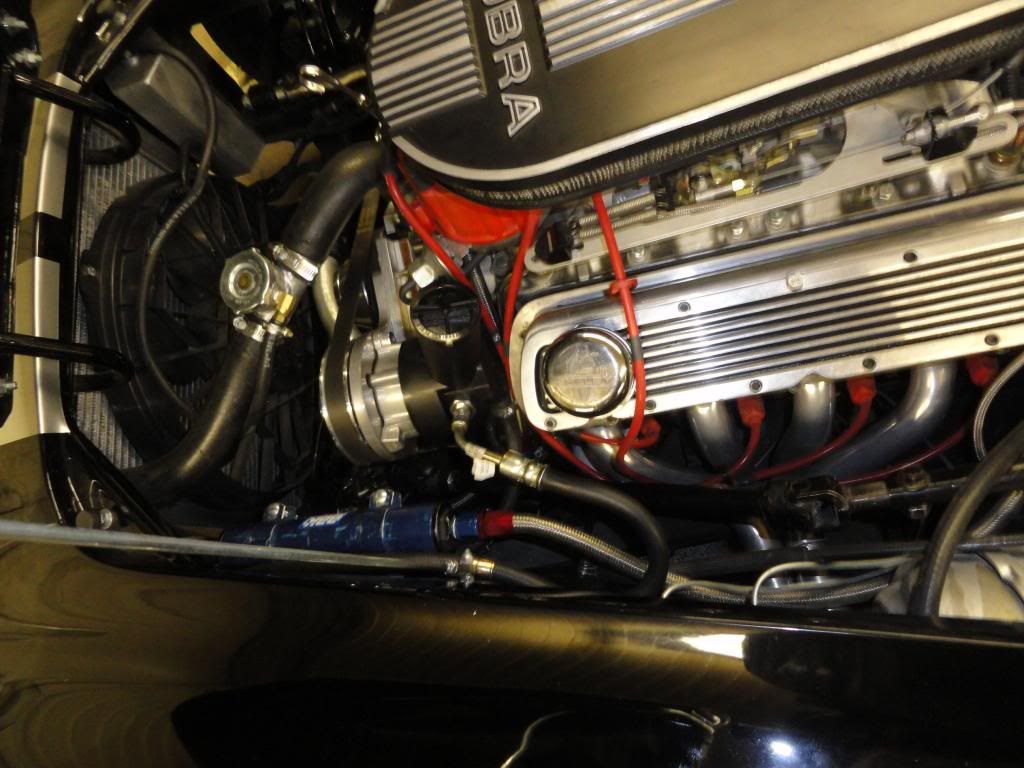

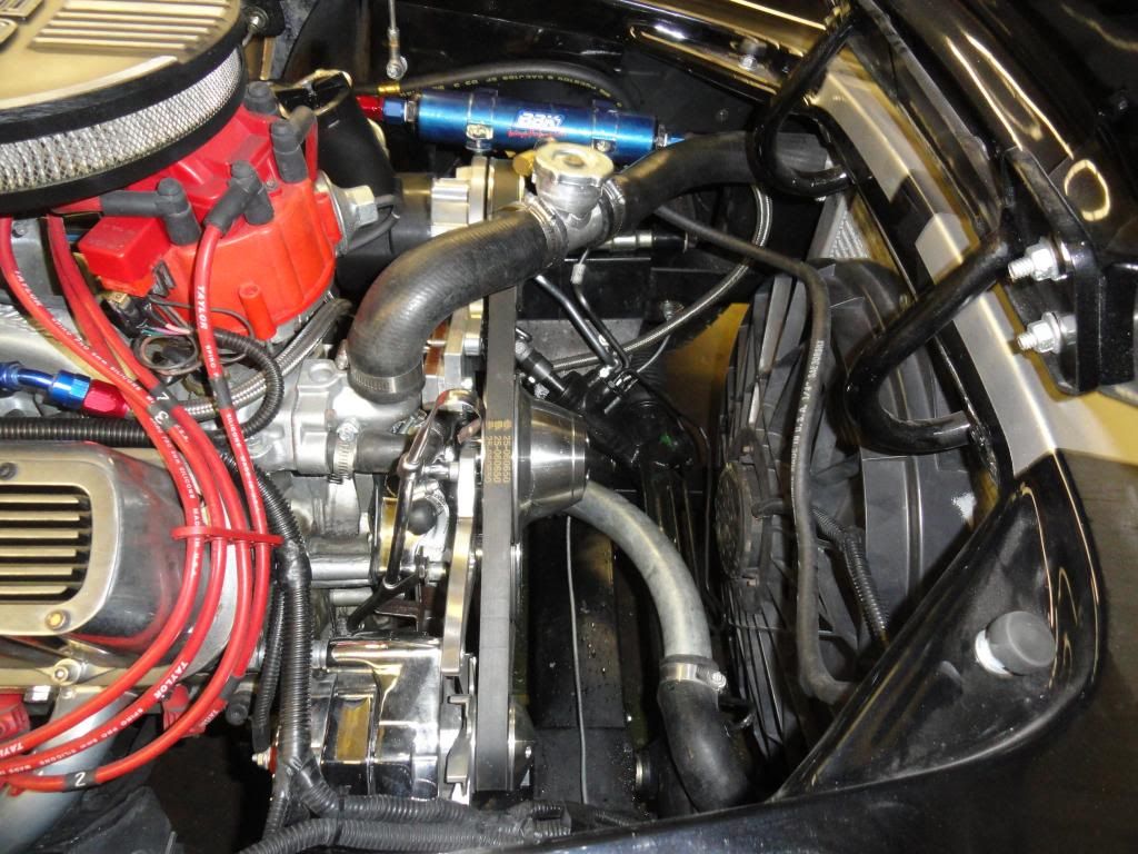

nope, all rubber bushings.  Maybe the factory five kits are better though.  This thing should kick ass once I'm done.  Getting rid of the manual steering too, for power steering.  Takes way too long to turn the wheel for the desired effect.  I could tell that driving it down our driveway at 10 mph.

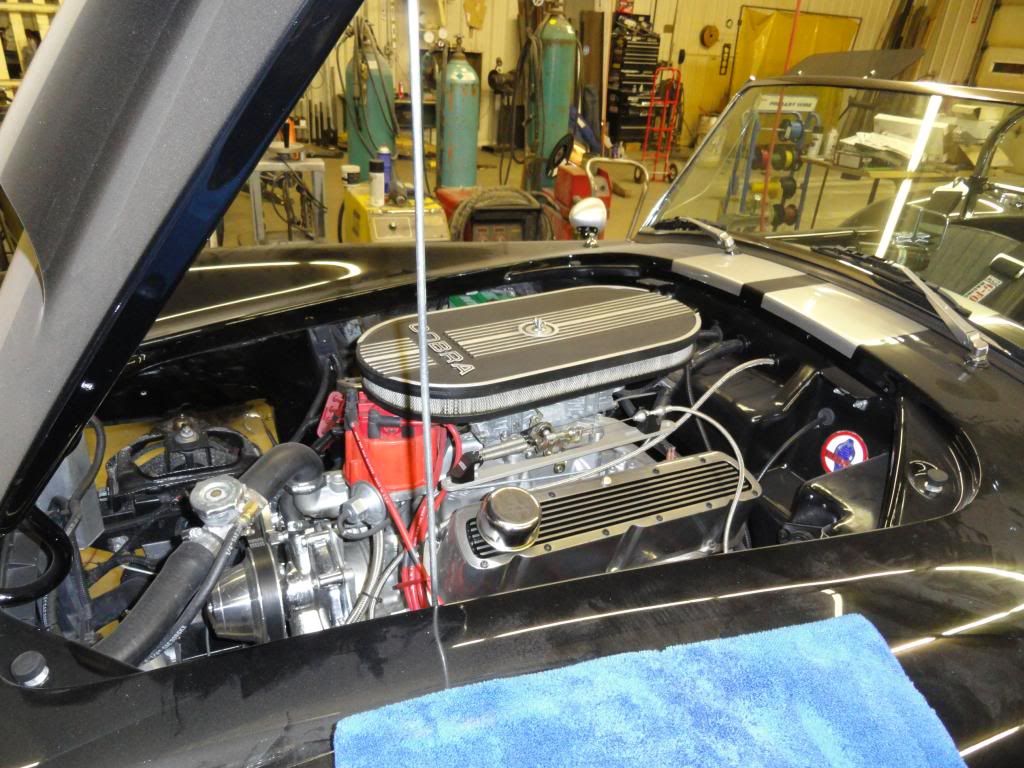

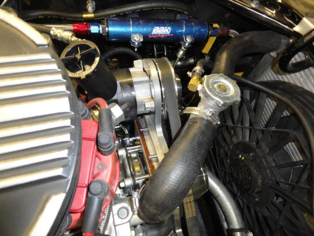

Almost done.  Have to finish up the plumbing and drive belt stuff for the power steering, put the front rotors and brakes back on, put a cooling fan back, and a few other things yet.
Now its got power steering!

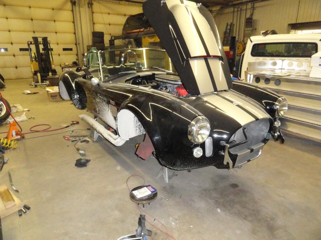

Never updated this, but after we got finished with all this work, the guys wife wouldn't let him race anymore so we never found out how it worked after all this.  Kind of a bummer.
