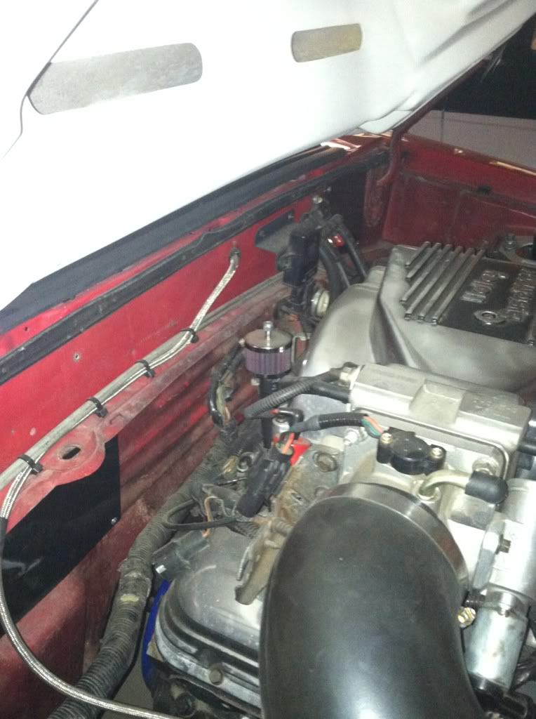

I ran a breather on the valve cover with the PVC hooked up for a long time one day a buddy pointed out that I'm pulling in un metered air I also had a large oil in the intake problem so I put a breather on the rear of the intake the pistons coming down push the pressure out

.....I really don't have room for a filter on the back. I have a/c lines there. I need the following...A way to run the valve covers as cleanly as possible and as simply as possible with out oil catch cans, vacuum pumps, and the like. An oil fill cap of some kind is easy. But the vent line.........
One day ill use a vacuume pump
This effectively disables the PCV system. I don't think that's what Vinnie is looking to do.

Prob not this is my race car
But if you run a aftermarket intake it will pull a ton of oil I was filling a oil separator in one trip
Just pointing out a valve cover breather pulls un meatered air
It's so little it's not a big deal but it dose

That unmetered air has already been accounted for in the ECU's programming.

Like I said its not that big of a problem but it dose pull it
I did this because I pulled a lot of oil
Just a opinion you won't pull so much with a stock ish motor
