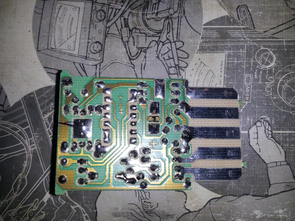

I'm using old model train power supply. If you look at this picture once again, you can test it the same way.
First and fourth lead is connected to +, second lead is connected to the ground. the third wire is the relay output (I'm using a test light instead of relay; relay - is connected to the ground) and the last wire is connected to one lead of resistor (aprox 140k) and the second lead of the resistor is connected to ground.
PS: I have two of these modules, but I don't have a car with autolamps. I'm going to modify the silver bird's wiring in the future.

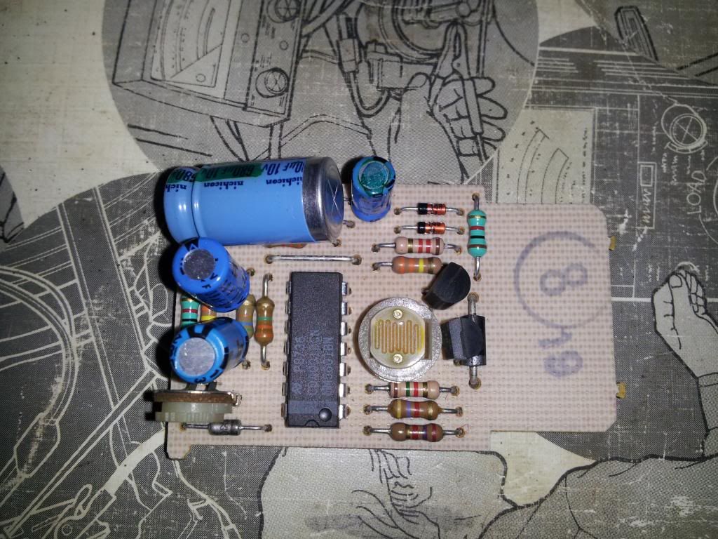

I've got mine open, and I'm trying to determine where the relay out power comes from, and I'm pretty sure it comes from that transistor that sits right on top of the diode. (Images are clickable so you can see them full size)
SOLVED !! internals of the auto lamp module
Yes, Q2 (as you called this transistor) is powering the relay out. Q1 is NPN type and Q2 is PNP. They are working together. The Q1 is just the voltage invertor for Q2.
If you want, I can make a complete schematic of this circuit at the weekend. It's very easy circuit.
PS: As you probably noticed, this circuit has only one safety feature. It's the D3 diode. It protects transistor Q2 agains the voltage peaks during switching the relay. When the D3 diode is gone, the Q2 transistor will say you bye bye too (most probably).

the middle solder run is the output power delivery to the relay,,
thank you trinom,, just confirmed that bugger is a PNP as well.
When you said earlier you your readings for the transitors are "from the top"  do you mean from the top as in typical Collector then base then emitter?
I still don't quite understand how you tied D3 to protecting q2  but that's fine I'm out here troubleshooting it now I got a little delayed
Are you sure you don't mean D1

I'm sorry, I messed it up. You are right. D1 is the relay protection and D3 doesn't have connected cathode. Look closely on the board. There is no path from this solder joint. You can throw away this diode. It's just useless weight :D.

I've noticed, that both of the transistors have EBC label, look at them closely. Q1E is connected to the ground and Q2E is connected to the battery power. Be carefull in selecting propper PNP transistor. It has to be able to feed the relay. I guess Ic has to be greater than 0,5 A.
Here is the output stage of the module
If you are trying to measure the transistor, don't use ohmmeter mode of your multimeter. It's useless. You should use diode mode.
PS: Transistor as a switch can be used only as a common emitor.
Jay, control the Q1 base voltage first. I think your problem isn't blown transistor.
When the lights are off it should be slightly below 0,5 V. When it's on it should be about 1,2V (I've corrected this value on the table on previous page I've found a typo in the numbers).

D3 diode isn't useless. I missed the path to the chip. It's the key!
D3C: when it's on, it has 5,2V, when it's off, it has 0V.
D3A: on - 1,2 V .... off 0 V
Check the first table, I corrected values for D3. I had to measure wrong pins yesterday .
Triggering signal comes from pin 4 of the IC.
