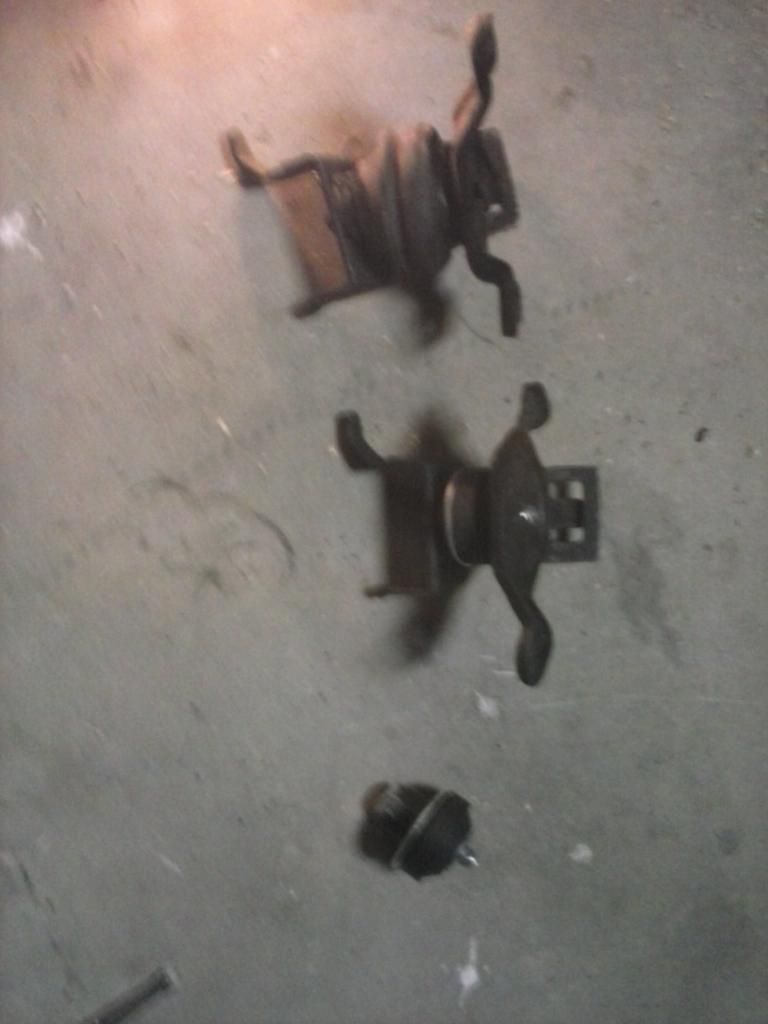

Took me a couple weeks, but here it goes. old vs modified, plus what the new mounts looked like out of the box.
I'm gonna loose 1/2-1" of height with this setup. knock the center pin out the bottom mount, use a very large drill bit, and it should be a bolt in affair. i only finished one side as i had to hand file the hole with a really, really py old file. my biggest drill bit was about 1/4" too small. hoping this new setup will clear and handle all 270ftlbs of torque my motor should be capeable of producing.
if the test fit goes okay, then i will clean up the mounts and pick up some washers to try and weld on top and.bottom of the mounts. this will probably require longer motor mount to block bolts, but should give me another 1/4" of height and fix my cracked/broken upper mounts.
then onto pulling the motor to get the bolt out that broke inside the block... i swear if this doesn't fix it, ill just go to a motor plate and forget motor mounts even exist...

Use the Chuck W mounts. Easy, and done. Cheaper than a block plate, WAY less work, and they will hold up easy to your engine, and future possible upgrades. Sometimes we invest more into a lot of small fixes than we would if we just bought what we actually needed from the beginning..
