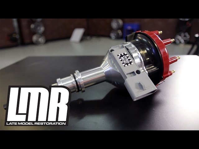

If I was going to replace my stock style distributor this would be the unit I would go with:
https://lmr.com/item/PDI-18457/1986-93-Mustang-50L-Billet-Distributor
Video on the distributor here that covers components and installation:
https://www.youtube.com/watch?v=QLgJOlIUfCk
It is made by Performance Distributors and can be had from their site a little cheaper:
http://performancedistributors.com/product/ford-hot-forged-dui-distributors/
They used to make a stock unit with a oil impregnated bronze bushing which is what I have in my car now.  I paid $200 for it back in 2007 but it appears they no longer make it and have moved to this newer style one which looks good in my opinion.  My guess is the one I have will last until the car leaves my cold dead hands as its been flawless since day one.  I do have a Motorcraft TFI module on it and noticed that LMR still sells them.
