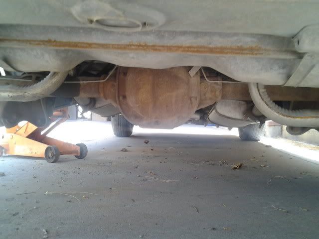

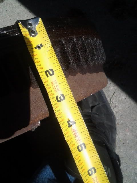

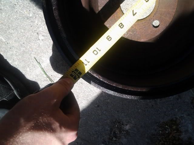

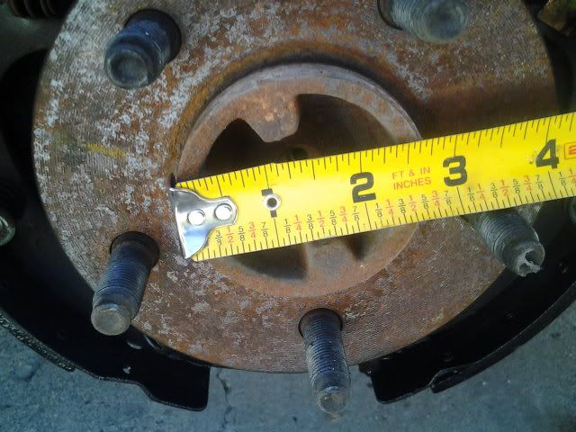

I'm going to pull my wheel and take some mesurements. My drums looked to be flat on the side.
10" drums, on a TC 8.8, with 5 lug axles. Update and success!
It'd be appreciated bub
Inner diameter is 11" for the drum. Outer is just shy of 12 3/4"
Center hum, I would guess to be 2 3/4" outside diameter.
Where the brakeshiznit is about 2 1/2"
Drum is 3 7/8" deep.
Backing plat stick behind drup about 1/4".
Any other pictures or mesurments you might need, let me know. I'm going to leave it off for a bit.

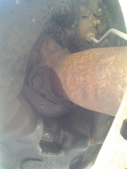

I guess I have. A bad wheel bearing and axle seal. I noticed yesterday I had a puddle by the tire. I thought it was the brake line, but my brake fluid is fine. I've had a slight noise, which I decided after taking off the wheel, my wheeel is rubbing the inside frame rail.
