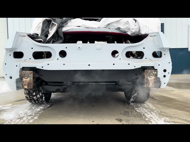

Back to working on the bird some. Last week or so got the dash installed and the fuel gauge sender switched over to the correct ohm range for the 03 cluster. Painted up the rebars and a few things for under the hood.  Installed the fuel tank, rear axle, some of the front suspension, and enough other stuff that I was able to get it running again. If I can figure out how to post a vid here I will. Going to try to keep at it enough to get it on its wheels and drivable. Keep running into little things needed to keep forward progress going.
Re: My 85 TBird
Reply #243
I was worried it was going to be way too loud with the homemade o/r prochamber and the slp powerflo lers, its a bit louder than the vid lets on, but am pleasantly surprised it should be a manageable decibel level.

Nice!
It sounds good!
Re: My 85 TBird
Reply #245
Beautiful work!
Sounds great!
Must be very satisfying to hear it run?

Thanks guys. I am pleased enough with the sound, hopefully its quietish in the cabin at cruising speeds.  So very satisfying to hear it run again, haven't fired that motor since Feb of 2013, and never thru the current exhaust. The car has not moved under its own power since the fall of 1998, hoping to change that here in the next week or so.  Got a few more things done today, mounted the front sway bar and got the end link situation figured out, put the drive shaft in, did some plumbing on the intercooler, rerouted the clutch cable and started to make a bracket to hold it out of the way. Also ordered some Linear sanding blocks today for final block sanding, should be here end of next week.

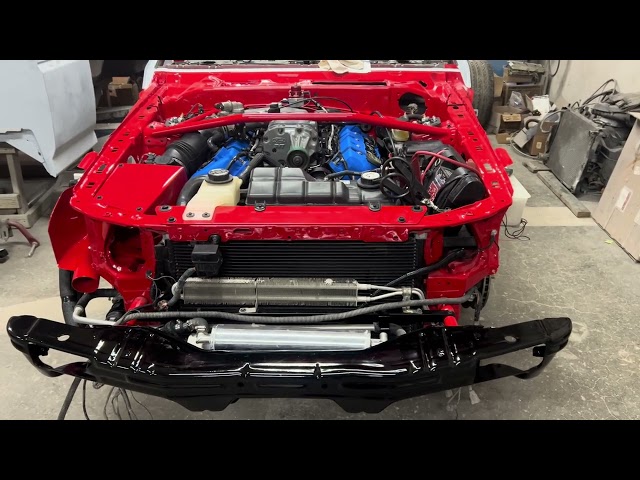

What’s the tank behind the bumper support?
Final body color to be that red? Looks like the red of my ‘03 Terminator: Torch Red.

The tank is to increase the capacity of the intercooler system a bit.  The color is ford code PQ, race red.
