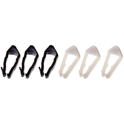

They have an assortment pack of 5/16 and 3/8
http://www.autozone.com/autozone/accessories/Help-6-pcs-5-16-and-3-8-in-Ford-fuel-line-retaining-clip-assortment/_/N-25gi?itemIdentifier=429540_0_0_
Help/6 pcs. 5/16 and 3/8 in. Ford fuel line retaining clip assortment
Part Number: 800-015
