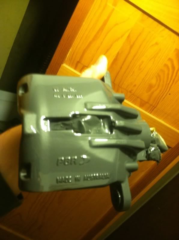

Here is a set of my C5 Z06  brakes i am installing. Blasted and painted with PPG waterborn and baked.

Quote from: TOM Renzo;383612
Paint the parts that is what i do!!
Don't let Vinnie see that, That looks like it would belong on his ride.

Quote from: Kitz Kat;383614
:rollin::cool:
Tom, how is that applied? Is it something you have to mix, or does it come ready to use?
I'm going to start tearing mine apart soon and paint every piece that can be unbolted...and most that can't. Looking for something that's fairly easy to use, and durable..lol

Quote from: ThunderbirdSport302;383615
:rollin::cool:

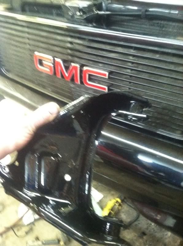

JR painted it and all the other front end parts. For the A Frames we bead blast them and use POR 15. But that Caliper is PPG WATERBORN engine bright. JR says it wont peal or discolor.
I am trying to OUT DO VINNY. I dont think i can.
Here is a lower control arm shot with POR15

Quote from: TOM Renzo;383842
how well does it spray? i've only ever brushed it on, but it's been years since i've used any
