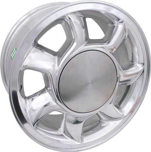

Got the new wheels on if anyone cares.  I will post pics later.  The vibration is still there...

Of course we care!

We'll care when we SEE IT!!!!!!!!!!!!!! :P

LOL!! I'm sure they look good. I just got a set of Cobra R's like yours. Now I need a set of plain centers for them. I checked late model resto but I couldn't find the plain ones.
