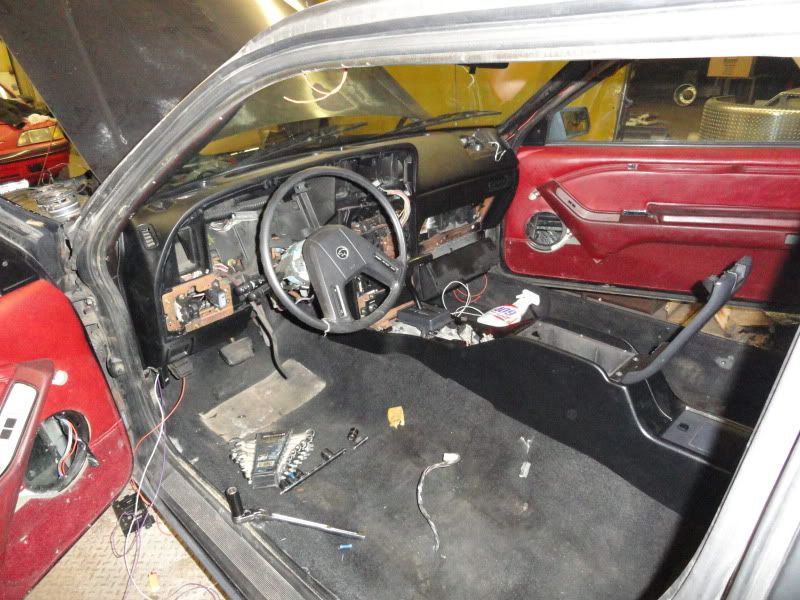

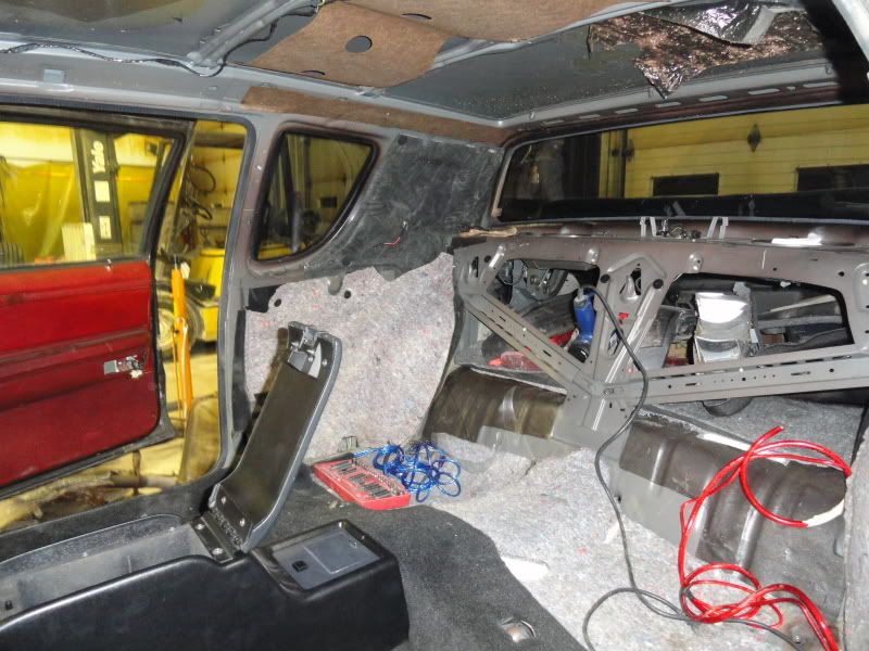

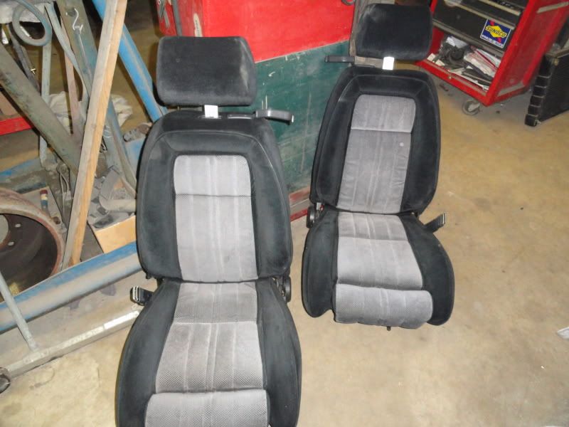

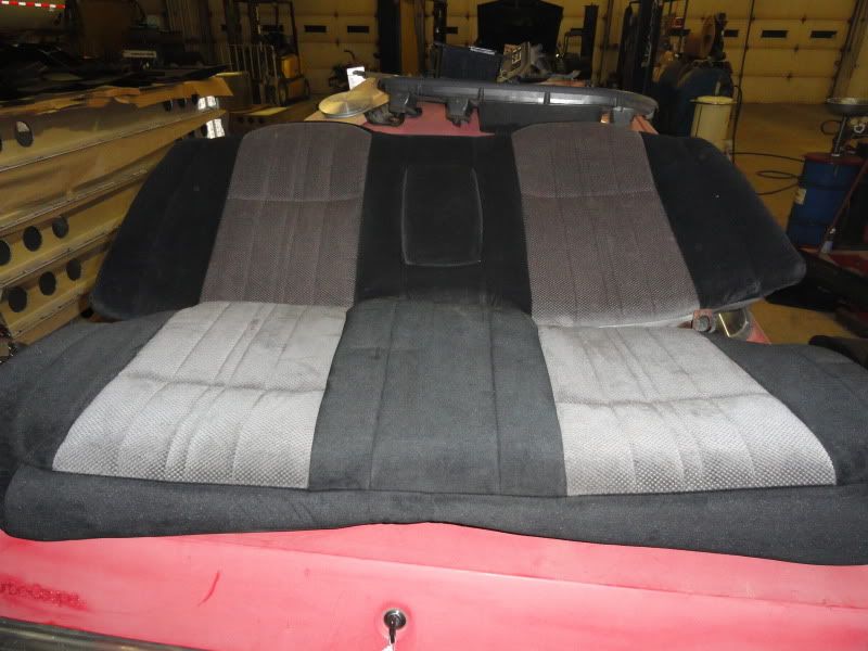

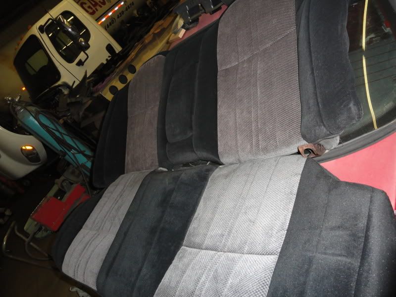

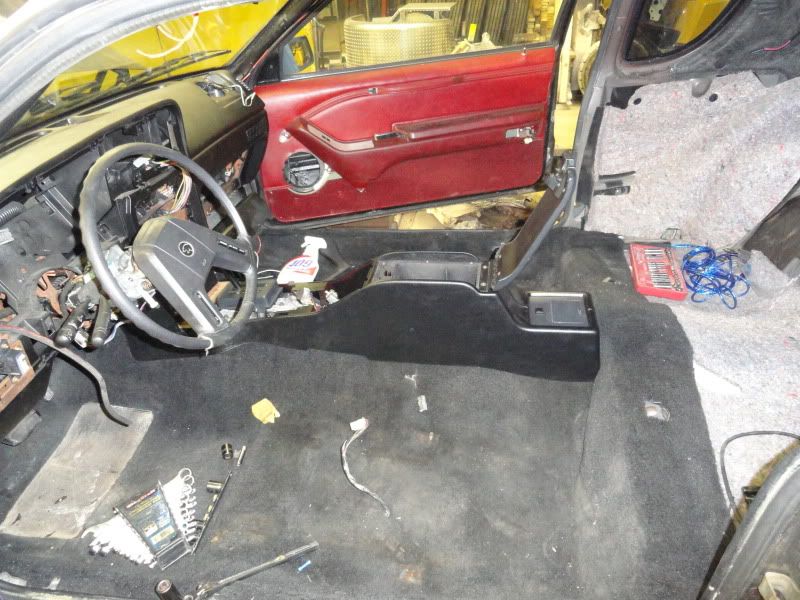

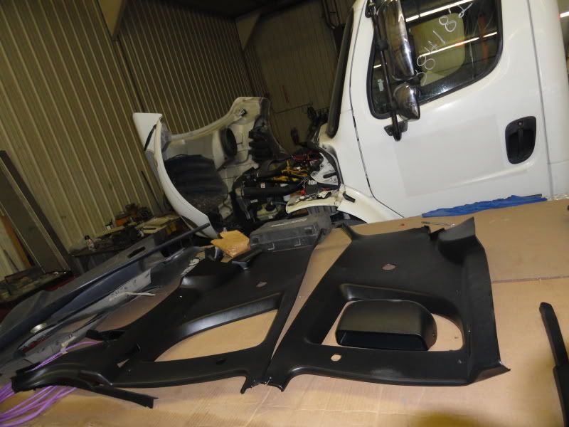

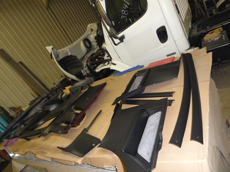

Anyways - freshly cleaned and painted turbocoupe seats, and I even took the one base off the festiva base bhazard put it on and got it all working right again!
Dash is pretty much back in, but the windshield wipers don't work on anything but high, so I have some issues already.  Starting to get the center console back together too.

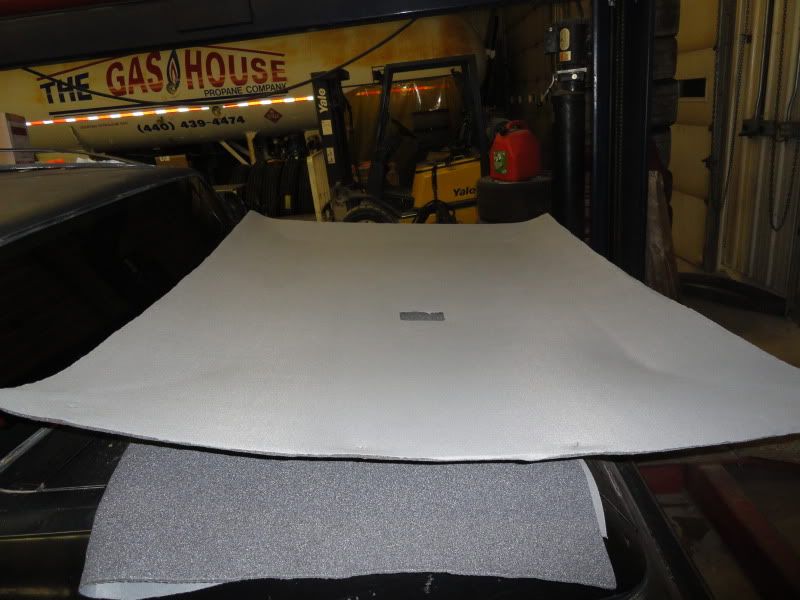

New gray headliner to replace the red.
Tinted the rear windows while I had everything out - 20%
Freshly painted interior stuff
As for the exterior, I havent made up my mind between Solid black, or a Black pearl  using the summit single stage paints.  They are the same price.  Thoughts?

What paints are you using? and for the seats too? Would like to change my interior to black instead of dirty tan. The black with grey looks really good though.
2012/13 winter race car
Wow, that is looking very nice!  More pics as you progress please.
Mike
I'm using Duplicolor Vinyl and Fabric paint.  I got it at Oreillys and Meijer.  The gray is just the factory raven centers.  I painted them because they were badly faded to blue.  The red that was in the car was all torn up leather.

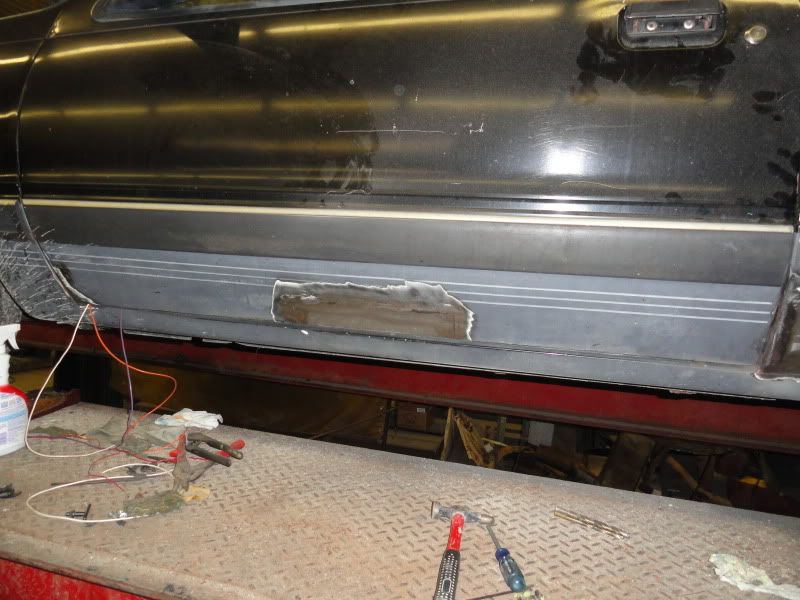

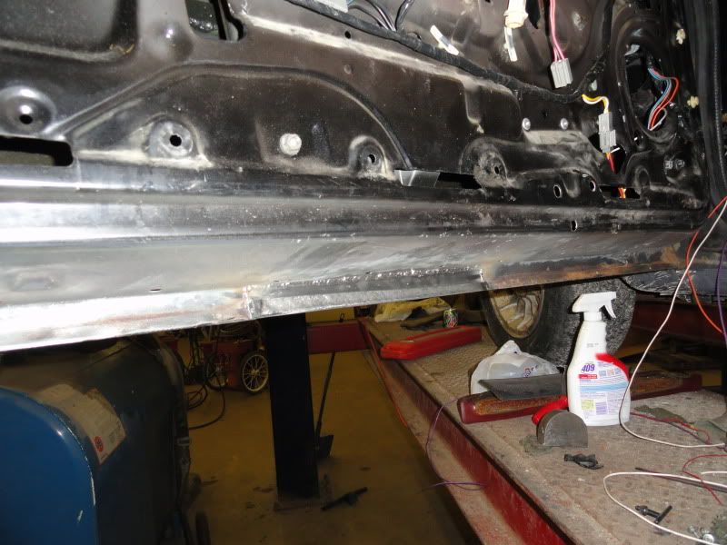

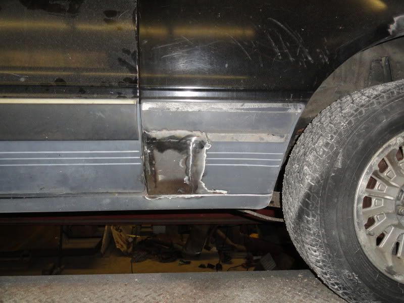

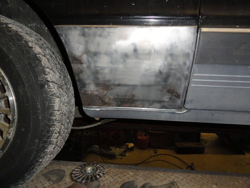

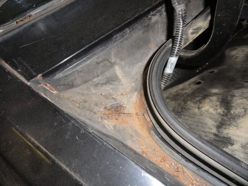

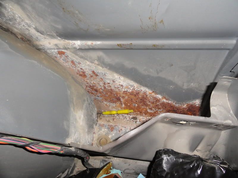

nah, just fixing rust.  Its alot worse inside than outside

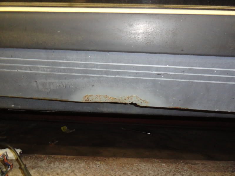

BTW brad, your dads definition of rust free is obviously different than everybody elses, rofl.
I think this is why its rusty where it is
All that water collected in the fiberglass sound deadener and just sat there.  Did that on both sides.

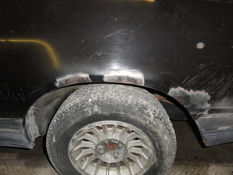

I replaced metal here too, but didn't take a pic of it.

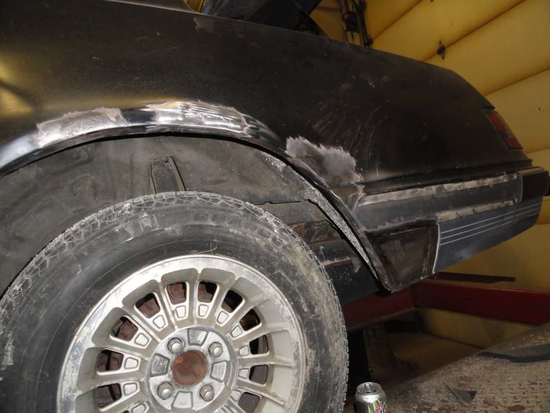

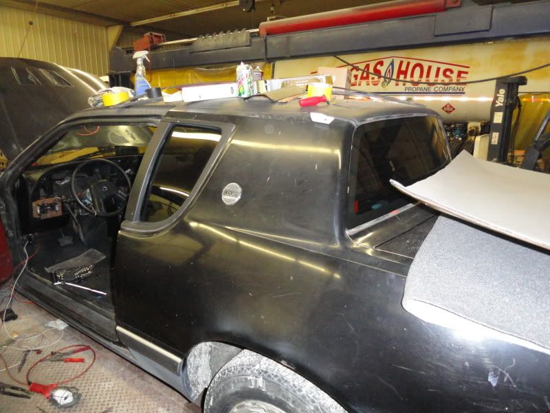

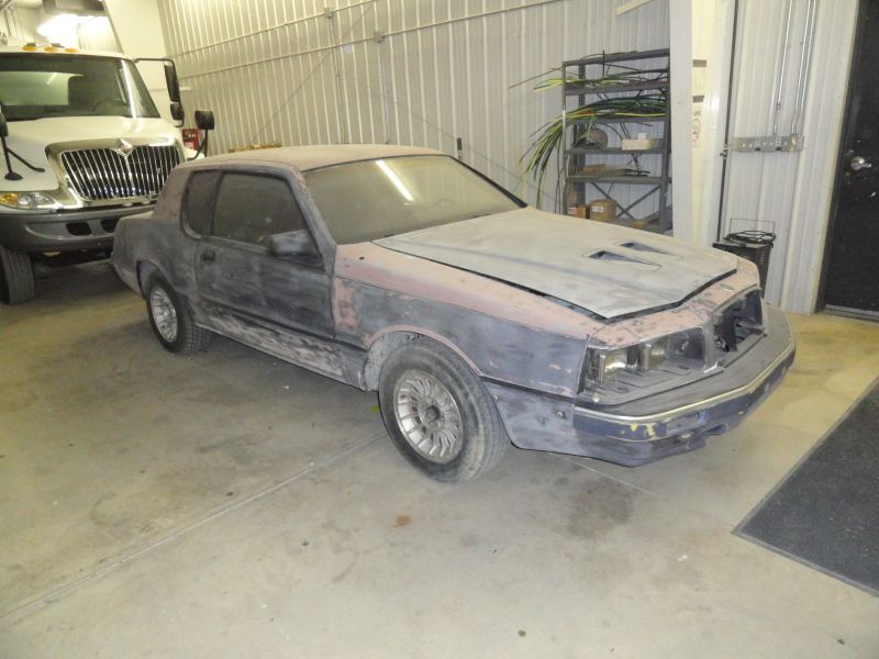

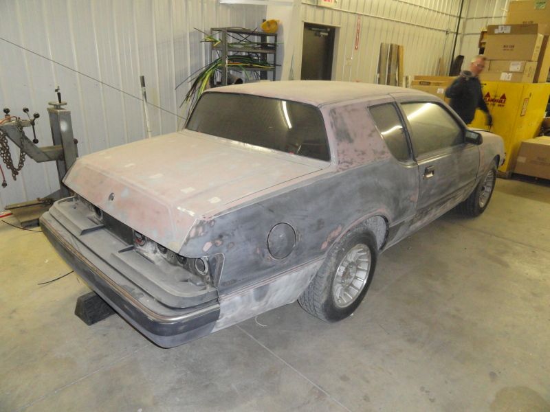

Havent worked on this car for a while, and have had parts scattered around in the shop so I decided I have to get this car painted and put back together for the most part before I can tear into my autox car again.  Heres the car with all the flaking clearcoat sanded off, but it has been getting smoothed out for the past week and slowly but surely, it will be painted soon I hope!
