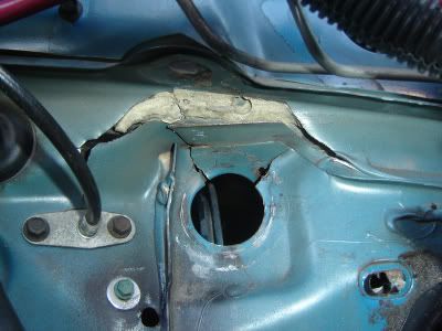

Okay I've been meaning to make a post about this for awhile.
This is (though not this bad which rendered the mustang undrivable) what happened to both my silver and black cougars.
In that corral thread, sure enough, the guy had a King Cobra pressure plate. I know the silver one has that, and the black car has some other super-heavy clutch. The silver one was worse because of the DUMB Steeda quick-release quadrant which has a bigger radius and applies the same force of your foot over an even greater distance just as fast, as well as due to its size, tugging the cable upward and grinding away at the firewall adjuster/grommet. The Maximum Motorsports clutch quadrant is a much better replacement for the stock plastic Mustang one. Look it up, they've put a LOT of thought into it and hell it's $39 as opposed to $79 for the Steeda one!
I didn't think to check the silver car until after I came home from LI getting the black one. The guy told me what happened to his car before he owned it, and, though not the cleanest looking fix, the owner before him had welded on a small piece of angle iron to s it up and sealed up and painted it all, giving that point lots of strength and it doesn't move at all. Sure enough though, sticking your head in there you can see where the silver car's firewall is starting to do what that mustang did. The MM quadrant made no difference in the pedal feel which isn't too surprising, but no more grinding cable. I had greased everything up before and was rotating the adjuster periodically to not wear a groove in it.
But the flex is ruining the throw of the pressure plate and shifting sucks. So I'll have to have that welded up and reinforced. Not the end of the world, but even at a little over 300 HP at the crank, this whole clutch setup is totally overkill and sure enough didn't it ruin something else.
Just something to watch out for if you have an upgraded clutch! Couldn't find a thread here anywhere about this, so I thought I'd mention it, plenty of us do 5 speed swaps all the time. Stop it before it happens!

Just to point out a little inaccuracy in the 1st post that relates to the KC clutch. The KC clutch actually requires 10% LESS pedal effort than the stock one but has approx 30% more holding power. The rapid release quadrant is the main case for firewall failure as it applies a greater rate of release to overcome the resistance of the pressure plate....kind of like a stout cam profile working on a valve spring.

I'd be curious to see the clutch cable from that car. I've personally repaired guys cars where they were in such a hurry to install and drive that they never knew what the spacer washers in the quadrant kit were for. They are used to be certain that the quadrant pulls STRAIGHT and not to the side which will increase the force needed to pull the cable and exert enough side loading to cause failure at the firewall. Also, the best cable to use is the Ford OEM piece as they seem to hold up better than anything else @ the track. That's what I'm using on the street with my KC clutch and Ford racing quadrant and no problems to date other than adjustment for wear.

Yeah the title does make it seem like my clutch grenaded doesn't it :rollin:  And now that it's mentioned I do remember seeing that somewhere about reduced force needed, I of course didn't believe that, made no sense but I guess that's also accomplished? lol
Which is definitely disastrous when it happens. But on the subject of the quadrant installation the MM unit I bought has those washers...maybe the Steeda one did but the guy sure didn't use them. From just eyeballing it though, side to side there doesn't seem to be much room for it to move anyway so as to rub the cable in that direction of pull, but the increased radius is killer, totally deflected angle, it should be pulled straight ahead, perpendicular to the firewall.
