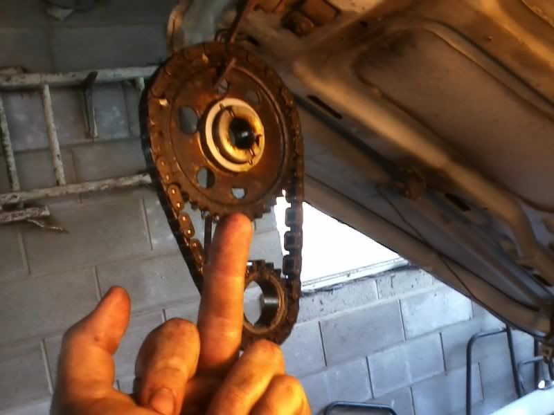

Replaced the timing chain and gears a few weeks ago at 114,xxx miles. Also needed a MAP sensor.
New Cloyes timing set FTW.
Plastic timing gear FTL.
Matt

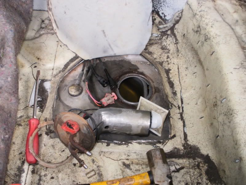

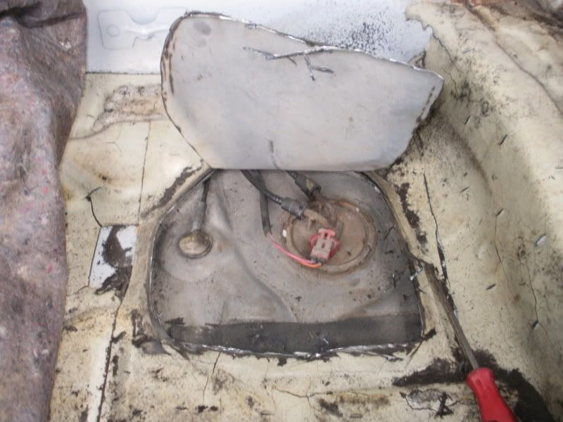

Well, the new fuel pump I installed last December decided to die after 4 months. At least it's still under warranty.
There's some advantages to having a car that's destined to be a parts car.

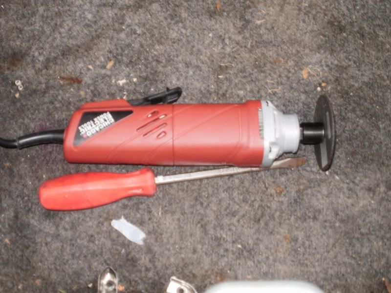

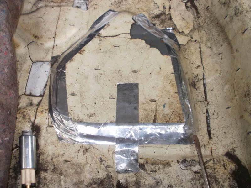

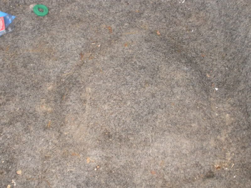

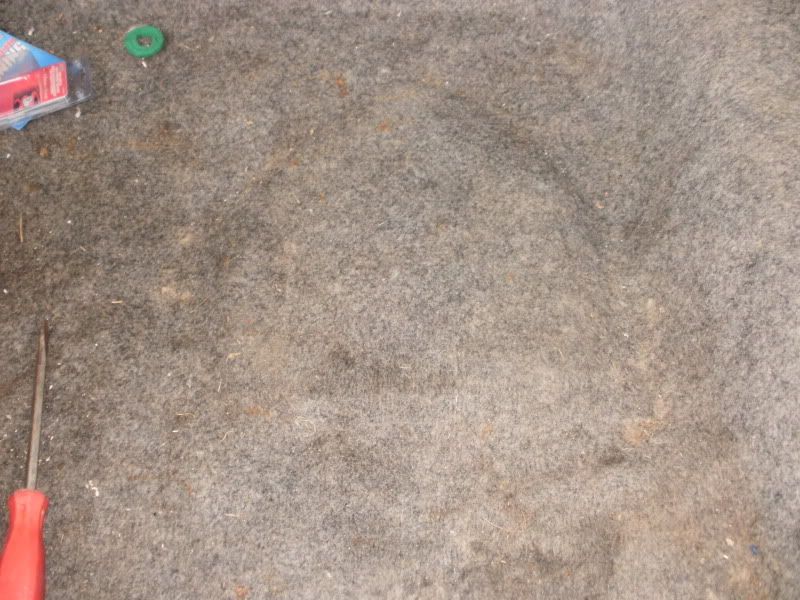

Redneck fuel pump access cover! :mullet:
When I changed the original fuel pump in December it took 7 hours doing it the correct way fighting with rusted bolts and balancing the tank on a jack, whereas this took 1 hour haha. I have to say I'm starting to lean more toward making the access cover on cars I care about. Maybe make a more professional access cover with a proper hinge, a rubber gasket, and screw everything down securely?

It really looks like there should be an access cover there from the factory. Of course, dropping the fuel tank is ridiculously easy on these cars. (Especially when you don't have any tail pipes like me)
