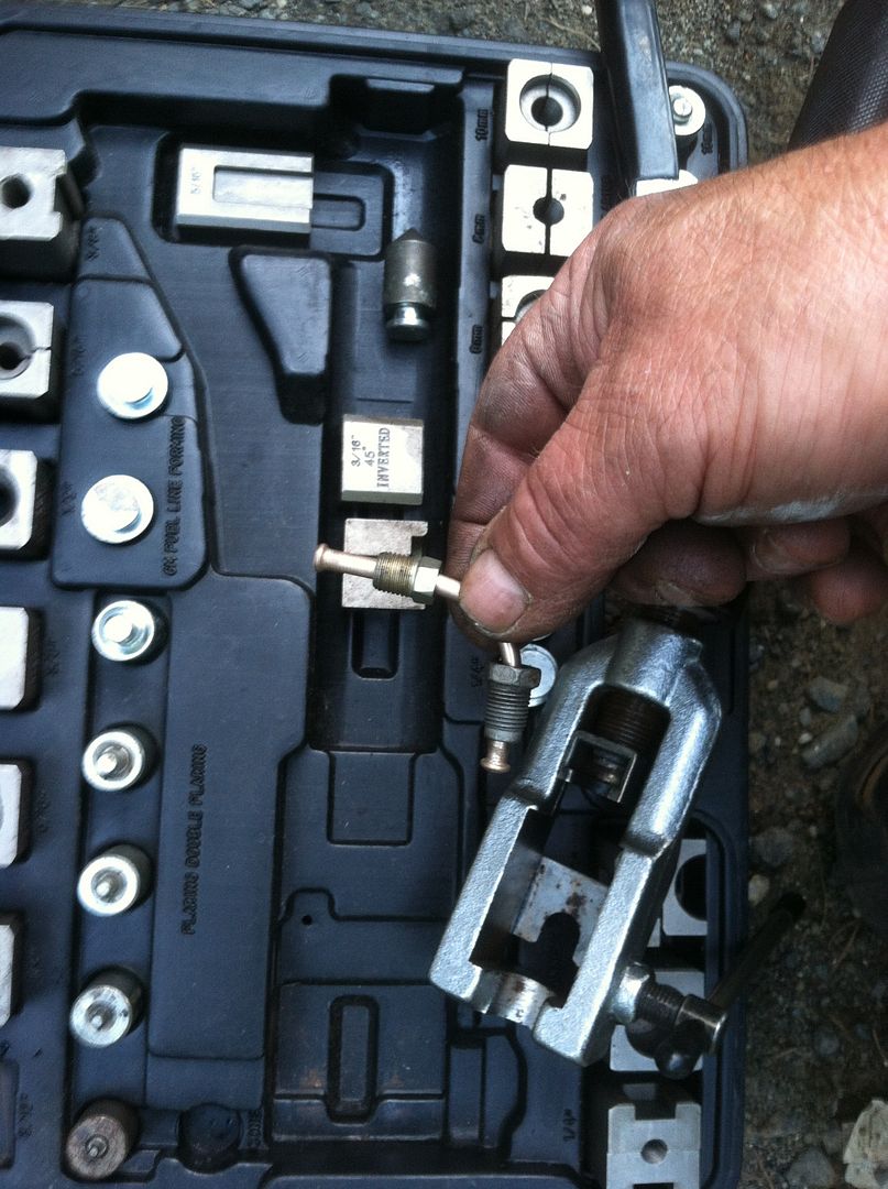

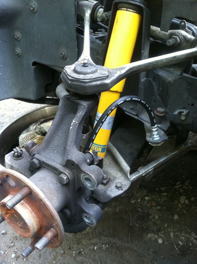

OK first thing is the Valve goes in the rear brake system ONLY. What i do is this I use a 7/8 - 1" cylinder for good pedal feel and replace the rear line with 3/16 all the way back and remove all the 1/4" line. (this is optional and the stock TC lines are 1/4 all the way back to the calipers) I also use a trailer brake fitting on the front lines to consolidate the lines to a single line and less complication. You need not use the balance valve because it is useless in my view and takes up space. The fittings are of no concern because the lines have to be changed any way. ISO bubble is much better than inverted flair. And Copper FERRUS is the line of my choice. I do not even use STAINLESS any more as it seals rather shiznitty and there is no advantage to using it. Unless all the fittings are new they have a nasty habit of leaking.
Here is a neat mounting bracket i made for the valve and trashed the balance valve and stock per-portioning valve
Sometimes you need both ISO and inverted flair on the same line. This line i made is for a C4 to C5 conversion. There is no trailer fitting in ISO. So i needed to make a different line set.
