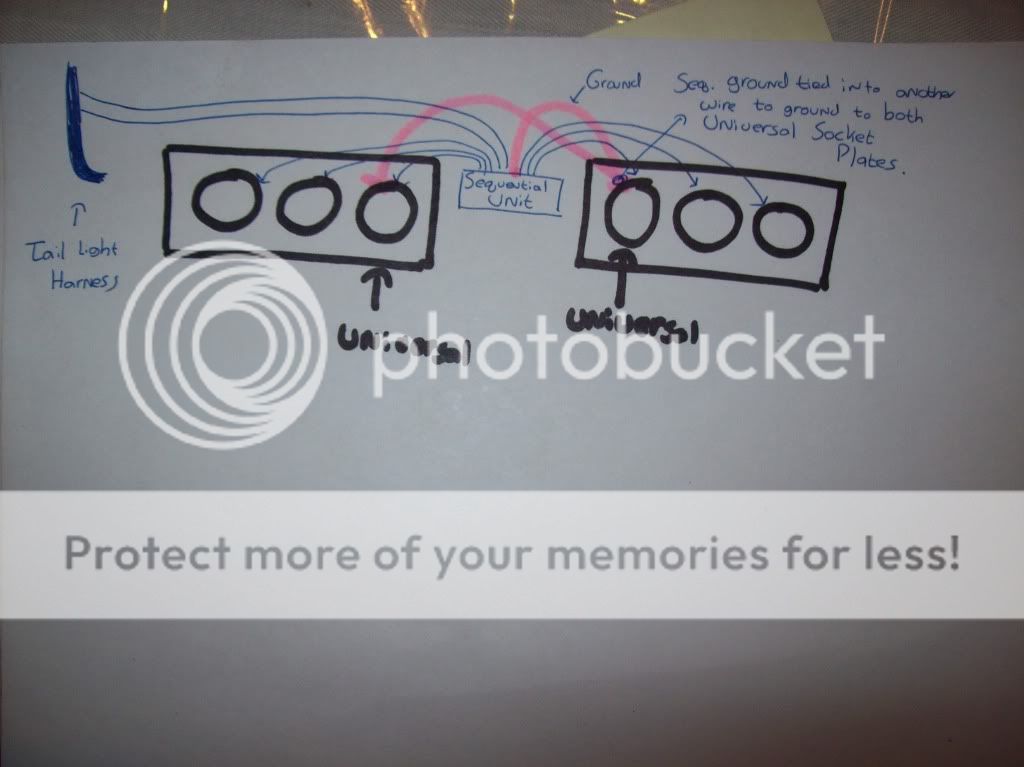

Well I figured out the problem. I don't know how to explain it, so I made a pretty little picture. Ground the sequential unit on the body of the car, or anywhere didn't work. The one ground wire from the unit, when ground to either of the universal lights would make that side work perfectly, but the other side not. So I grounded them both, and everything seems to work okay. I'm not an electrician, and I can't explain why it works, but it does. That's good enough for me, I suppose.

I've not heard of this problem. The sequencer has no control over the innermost lights (the universal socket ones). The wire going to them from the sequencer is a direct pass-through, the sequencer only delays the center, then the outer lights. The innermost sockets should have no effect on its operation.
When you say they don't work with the brakes on, do you mean they don't work at all, or that they simply don't sequence and instead all flash at the same time?
Also, what do you have that sequencer's ground wire connected to? I see by your diagram that you've got it connected to the universal sockets, but what's actually grounding the sockets?

I mean they simply don't sequence. The diagram has changed. I ended up grounding the universal sockets directly into the taillight grounding wire. I think maybe the universal socket is the problem. If I disconnect the left one and let them flash, the two outer ones work. Maybe the socket is loose, I'll pull the spring and try to make it tight again.
