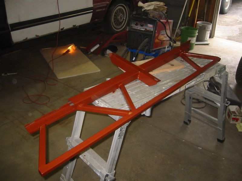

I used 2x2 and 1x1 for mine. cost about $70 to make

Those are the nicest looking connectors Ive seen any chance of a set of plans? to copy those?  :hick:

here's a pic while I was putting the fuel lines in, with Chucks seat supports

Quote from: daminc;350671
I see a  on the back end that's not in the drawing is it self explanatory when mocking it up? And Chuck do you still make the seat reinforcements at 6'6" 310 lbs I'm gonna need help with the floor someday?
