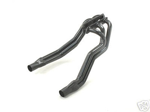

Hey just found on cool cats, a site that sells mac long tube headers for the 3.8 mustang.  Anyone think that they would fit any different from the Pacesetter long tubes?

Hmmmm.....
pacesetter:
mac:
well the mac's certainly look waaaaayyyyyyy better
its a tough choice. they both look like they have their advantages as far as fitment, but I think the mac's do take the cake.

I just pulled that pic a couple of days ago from their website.
