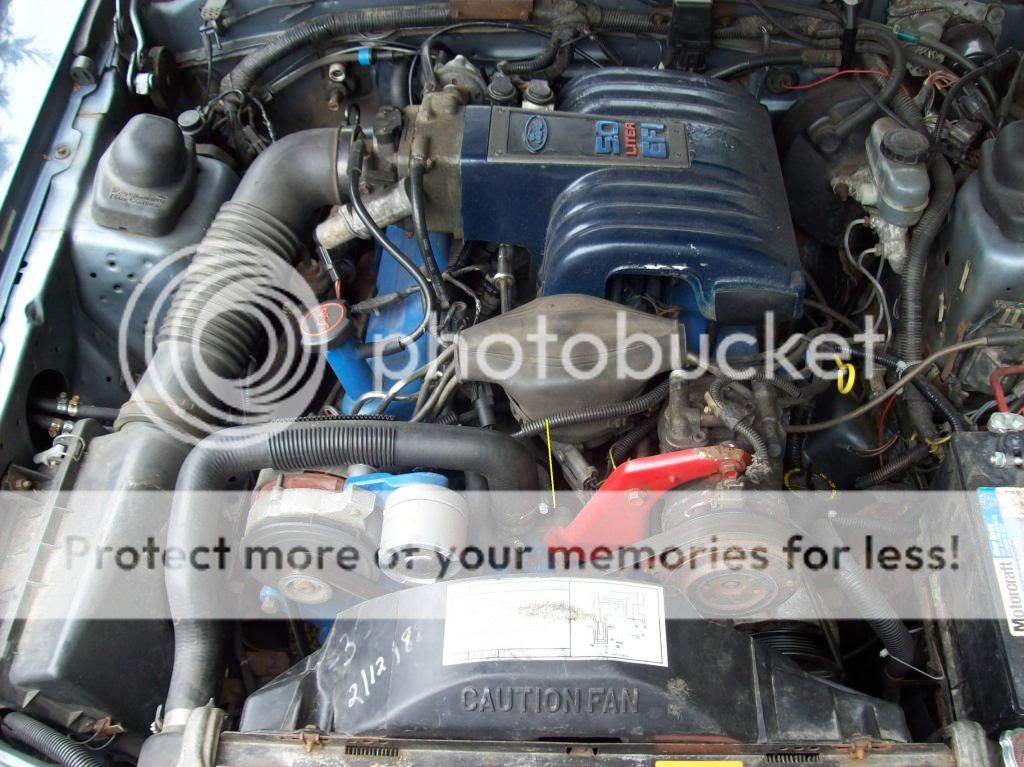

On the attached picture, this is the motor shortly after it was put in the car and you can see where the distributorand TFI are located. This was before the intake gaskets were done and there was no noise. The yellow line represents roughly where the TFI sits now, its as close to the thermostat housing as possible, its touching it. Now if I move the distributor counter clockwise to move towards where it used to be the engine runs real rough.
I just feel the problem has to be related to something that was disturbed when the upper and lower intakes were taken off because it didn't make the noise before.

If your distributor is not pointed the same way, it is not in right. If your timing is off alittle bit the car will still be fine power wise, but may ping sometimes under load, which would make alot of sense.

My dist points kinda towards the front driver corner close to what you have now.  if your slack is excessive, you could be set wrong but looking correct.
dont forget to eyeball that rotor button pointer real good when you first take it off, that will tell a lot.

When I did my timing chain, I am fairly sure I put it back in a tooth or two off. Looking at my dizzy, it looks the same as yours, and I had a timing issue. I ended up unbolting the brace behind the A/C pump and turning the dist as far as I could. That solved my overheating and pinging.
