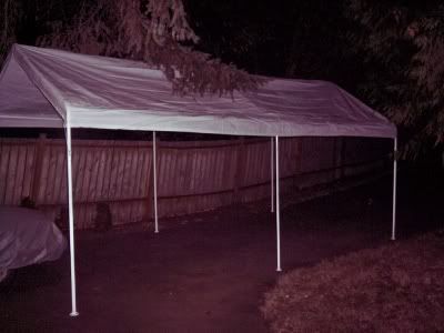

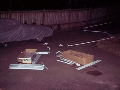

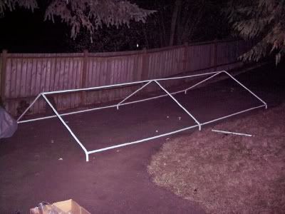

Here is some pics~
Getting ready to set up, Middle of the night, Cleaned up the inches of tree debris and the weeds at the fence line during the day as well as mowed.
BONUS! Pic of my "Elusive '84 Thunderbird" (Kinda ;) ):
Top Frame:
All together minus sides:

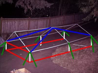

Heres a quick and crude mock up of ideas for reinforcing the frame:
Lower red would probably be wood, to allow for further and future attachments or hold downs.
Upper red could be wood, pipe or pvc (depending on structural needs to be determined)
blue would probably be pvc, just for extra stiffening and to hopefully get rid of some drooping in the roof tarping.
green is tie downs that would go in the ground, or attach to the fence.
Legs filled with cement and fitted with rebar to provide extra strength, and more importantly~Weight.
Throwing the idea around in my head of digging holes into the ground and fitting pipes that the legs would fit into, Similiar to how you seat a flagpole.
But... One side i would have to go through concrete to do this.
I could also have the rebar sticking out of the legs as the cement in the legs dries, thus making the need for the "socket" hole in the ground much smaller.

Wow that looks very weak.
Will need quite a bit of work to reinforce that.
