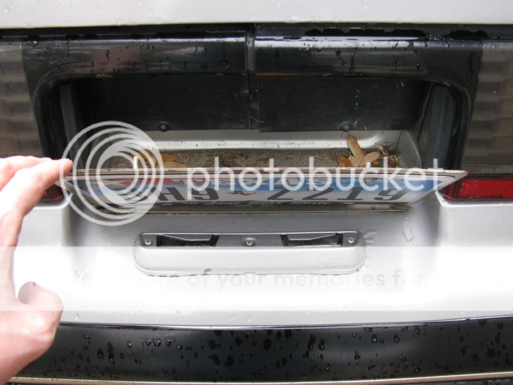

FP should be about 39psi w/ vacuum, 41psi w/o.
and that's interesting the license plate flips down. i haven't seen that before.
1979 Ford Fairmont
[/B]
Fuel Pump/Tank: Update post 40
He said the license plates are all like that in puppiesan.
