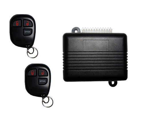

You won't have to rewire anything. I had no problem wiring my trunk release to operate with the remote. With the trunk release switch in the glovebox, the switch is wired 12v+ from the ignition key only and the opposite wire is pink which carries the voltage to the trunk release actuator. So just connected to the pink wire on the back of the trunk release switch. Keep in mind you do have to install a couple of relays not included in the kit for dome light illumination and trunk release. A couple of the signals from the Audiovox unit I bought use negative pulses, so the trunk release has a relay to convert the negative pulse to switch 12v+ to the pink wire on the back of the trunk release button. You will better understand once you see the wiring diagram in the installation instructions.
I did a cut and splice with butt connectors and electrical tape to seal the connections. I would avoid using scotchlock connectors but it can be done using those too. A proper splice is to cut away some of the wire insulation without cutting the wire in half. Then you wrap the bare wire you want to connect to the bare wire you are splicing into and solder it and heat shrink it or use quality electrical tape.
I like doing quick connections so I have always been a butt connector w.
This is the Audiovox unit I bought off eBay. It is the only one I found that has all the features including a trunk release. Be aware that other units on eBay only unlock doors and do not have options for trunk release, dome light illumination, etc. The control module is much smaller than it appears. It's about 3 inches square.
