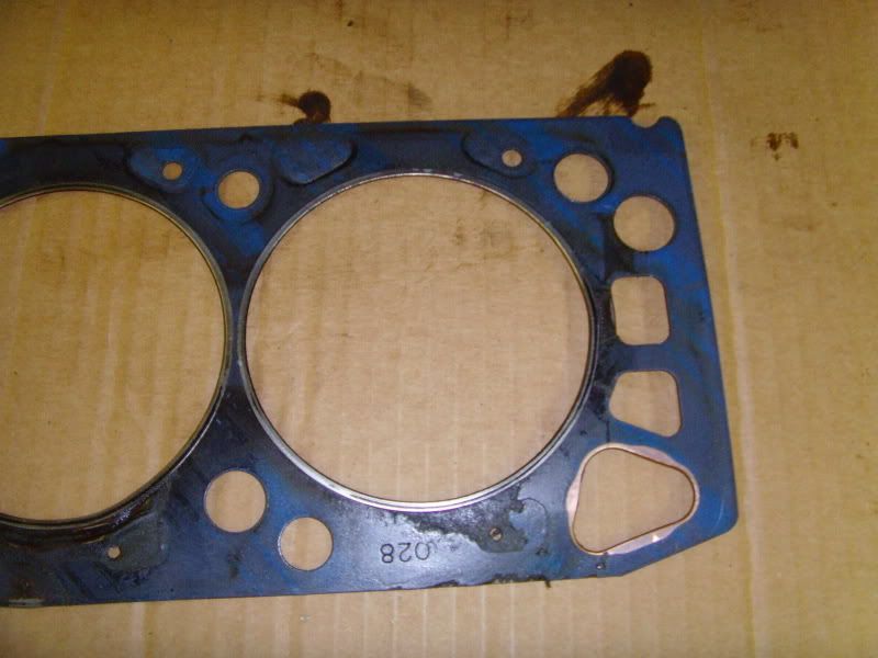

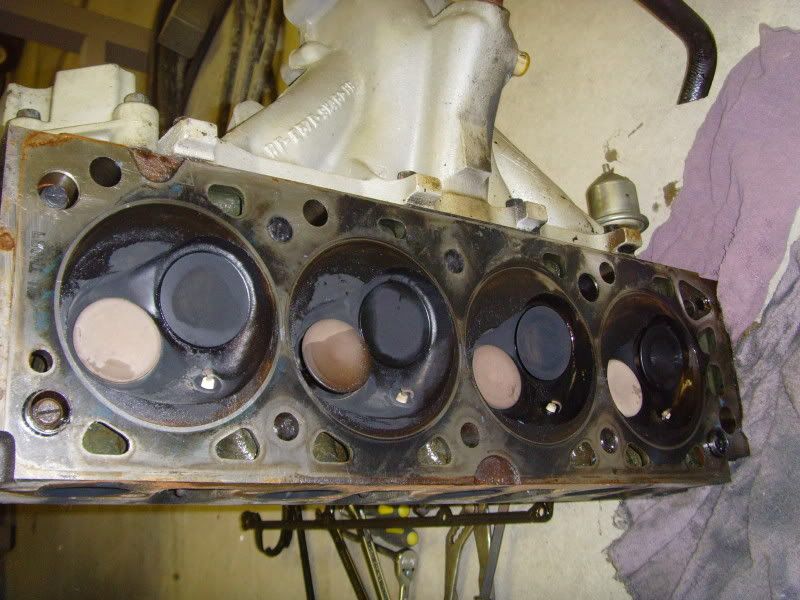

Tonight was spent tearing the top end back off my engine.  Finished blowing the head gasket at lunch
6:45 tonight
9:00
This was a felpro 1035 gasket
Mine definately isnt as sweet looking as crystals was, and I think mine was alot less messy too :rofl:

whatcha think about a set of copper gaskets just out of curiosity?

and as far as the copper gaskets, not sure.  Never heard anybody talk about anything other than the 1035 on turboford.  Some run the 8993 and have it lasting.  When I originally put that head on it, I had the head surfaced, but didnt do the block.  New engine may have that done.  Not sure.  I have been fighting a misfire above 26 psi and I think that was partly the cause.  Again not sure:mad: But it will be doing :burnout: again shortly:evilgrin:

Don't bother with the 1035, they're actually designed for a race oriented application, where the fire ring doesn't exactly meet the combustion chamber where its supposed to.
Run an 8993, with it running properly, it'll last a long time. I ran 22psi of boost for the longest time, on brown top injectors at 40psi of boost. When I pulled the AFPR off, I blew a gasked...in Ohio.
Thats mine.
It's Gumby's fault.

Pffft, you call that a blown headgasket? Please :P
That sucks though.

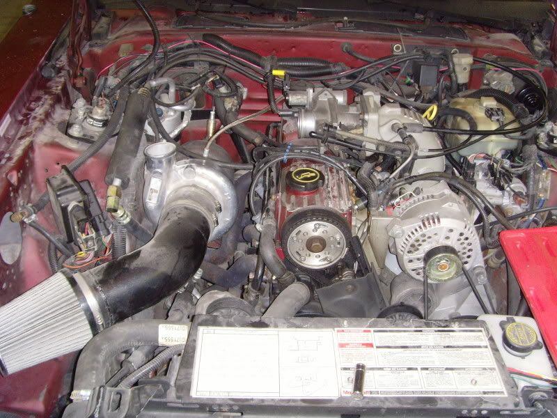

maybe it will run right after this, lol.  I'm kinda glad it did it close to home and did it when it did, because I thought something looked kinda screwy with a valve in #4 with dads borescope.  So far I havent found what I saw, so I dont know what it was, maybe just a reflection.  Maybe I will get the cam lined up right this time too, rofl.
