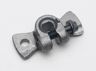

Been looking around and I keep seeing these adapter kits for the shaft. I hope I dont need this.
Anyone done it that can chime in?
Manual rack?
I do not think it is an adapter for the shaft, rather a smaller diameter shaft that does not include the rag joint that alwayshiznits the headers. A Manual rack was installed in some of the earlier fox's (most likely "never" a T-Bird) so I am sure the shaft "adapter" is not needed. The "adapter" just has no rag joint and utilizes two U joints instead. This is not an adapter, but rather a replacement piece. You do not have to use the flaming river rack, hit auto zone and buy a replacement mustang/fairmont piece for half the cost or more.
Manual rack?
i believe he's talking about this adapter...
manual racks(both FR and factory) use a different size diameter for the steering shaft to mate to the rack's shaft. this piece is used in conjunction with the stock rag joint.
