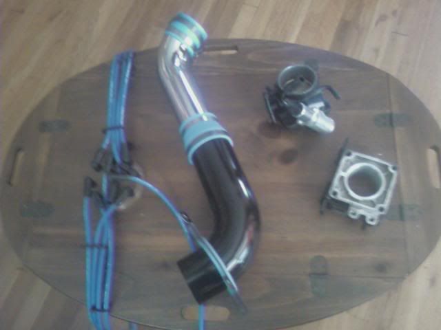

Installed my 65mm tb, 65 to 60mm egr spacer I made, new IAC, my CAI, 9mm ford racing wires, ngk plugs, accel cap and rotor, motorcraft oil and filter, and my nicely painted explorer intake plaque. All and all a good day. Have to pull the TB again and get a real gasket, its sucking in coolent. Pics coming tomorrow!!

I put some seafoam in the gas, plugs, wires, cap, rotor, oil change, and my CAI, o and a new IAC

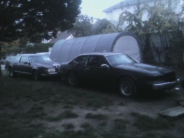

I got a TON done on the car, mostly little , but step towards making it what I want it. Got the entire front clip off, and the whole front clip of the blue car, prepped and painted flat black and ready to go on. Lights are polished and ready to go, grill is painted and ready to go, as are foglights(need to find out why they dont work on this car either...). Pulled door panels, started replacing broken parts, fixed power door locks(car had no actuators), painted red parts black, painted dash cover black, just little things to make it looks better. O and its got its first cleaning in 3 years hahaha. The red isnt to bad when its clean!
Also installed pioneer door speakers, and my old cars factory JBL 3 ways. Those things ROCK for 20 year old speakers!!! Still got a TON more work to do inside before I'm happy with it.
Tomorrow the front clip and lights will go on, then its on to redoing the front end. New control arms with poly bushings, my old cars front bags and solenoids, my KYB's, T/C sway bar, and my drilled rotors and new wheel bearings. Should help handling ALOT, and keep the front end off the ground! Ordering a trac lok rebuild kit, and a full bearing, shim, and seal kit for the rear end in the blue car. Gonna have it redone and gonna install it with new control arms, poly bushings, and im getting a set of the spherical bushings from UPR. This way I have trac-lok for the winter, and the rear end is leaking anyway so it will be a very nice noticeable upgrade(I'm keeping the 3.27's)!
5 more days till the insurance is all set, and then its registering it and inspection!! So far everything is on schedule!
