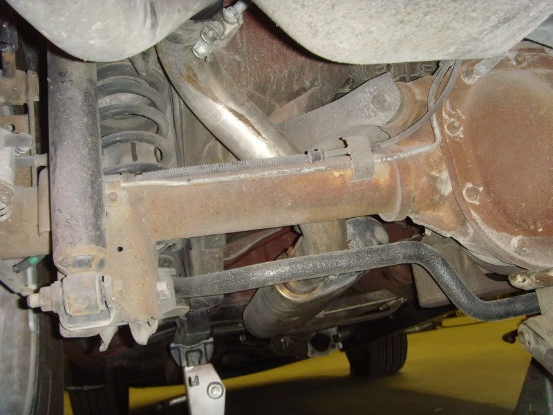

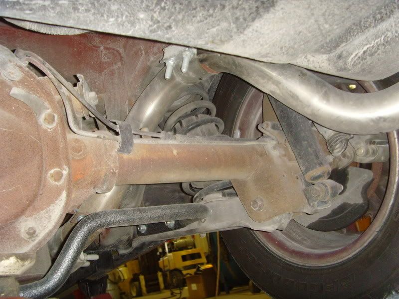

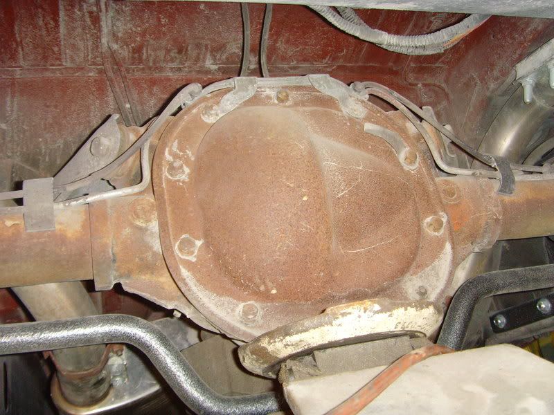

I just wasnt sure about going around the rear axle with the brake lines and abs wiring going through there right up near the top of the axle.

yeah you have to be careful going around the axle tubes as it is really easy to break a brake line off....  seen it happen to a buddies car when they strapped it on the dyno...

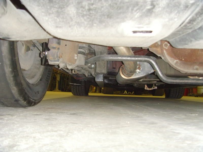

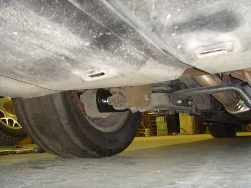

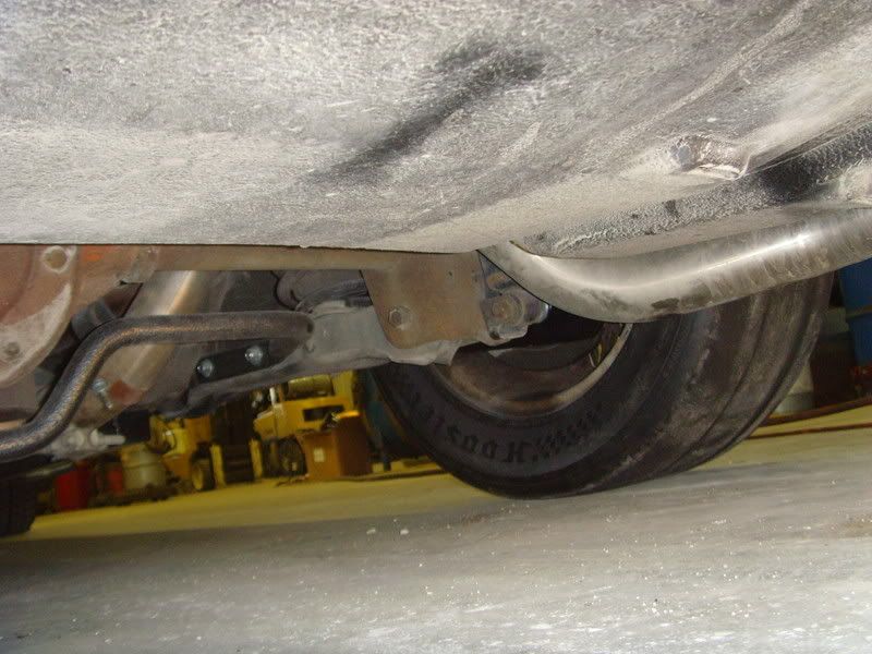

well, heres the solution in the rear, and why I was having so many problems trying to find places to attatch to.  Front will come later becuase I didnt have time today
It would seem a little unnerving to trailer it a couple hundred miles with the brake lines where they are at
Solution is 1/4"x3" flat stock bolted to the lower control arm bolt and shock bolt.  Pass side is really close to the exhaust, so I may end up tweeking that one a little bit

very cool and practicle idea...  why not run the control arm bolt through it?
trailering Turbocoupe ???'s
it is through it on the other side.  I probably would have put them on the inside of the bracket if the bolt was the other way, but going on the outside gives it 2 bolts it can go through, just needs another little bend in it to do it.  I also had my doubts the bolt would come out easily, and I didnt feel like fighting a spring this afternoon either, lol
