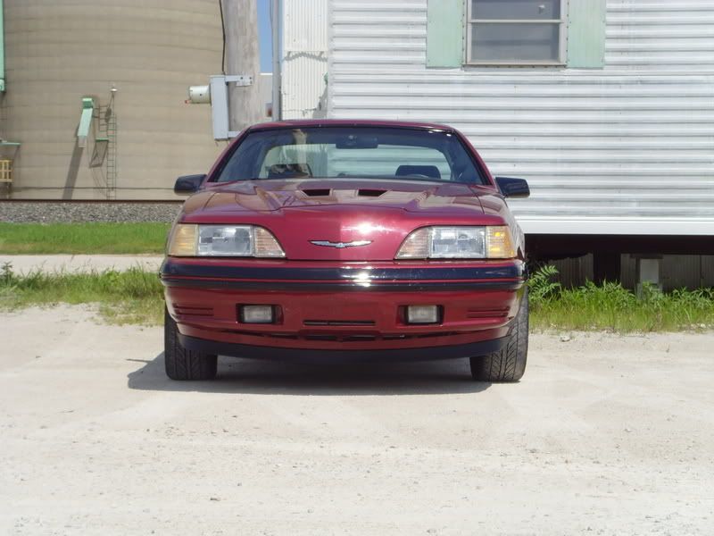

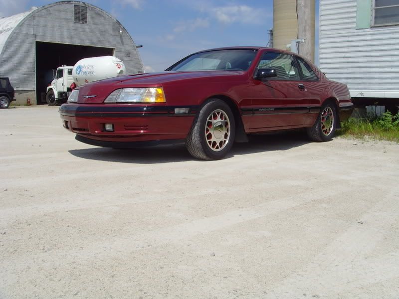

One of the mach 1 spoilers:D

welcome to the club! ;)

Sweet!
Gotta get off my keister and get one!

Very nice!!!! I want one.:burnout:

omg
that car is beautiful!

I got mine off ebay.  Its for an 01 mustang mach 1
Thanks for the compliments guys.  You'd never guess its around a 330whp 4 cylinder, rofl

Do they fit right onto out cars? Are any modifications needed?

I had to cut the top part where it clamps in the corners, but otherwise, I used the center hole to locate it to the center screw from the old one, and the two outer screw holes I moved a little to get it to fit right.  Then I drilled new holes and used the push clips that were included(not the christmas trees, but the ones with the push pin in the center) and you also have to cut off the ends some because otherwise they run into the tires

Thats the same color as mine, Is the color called Ford Medium Red thats what I heard.

And yes, it is medium red.  Kinda a lame name for it though.  Thought it would be a little higher class than medium red, rofl
