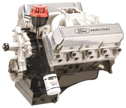

If it's this one: just dump it in and don't open it up.
How possible? Pics of block and trans....3/18/09
i dont have the specs on the tranny yet but the truck its coming from is pretty much made to haul stuff so the gear ratios are tall and slow im only  worried about blowing out my driveshaft cause for now its going to be my stock one shortend,, and looking for a posi,.,.,.,and my block is definately not that pretty obviously,,, and the covers dont say racing but it does have a holly 4 barrel and the same type of intake manifold,,, but it has the stock exhaust manifolds,, its probobly just a stock replacement motor with some add ons..im in the process of pulling it now....the things a beast!!!!!
