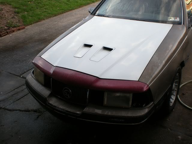

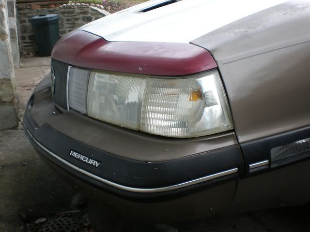

I had some daylight left after I got done work today, so I decided to tackle swapping the hood! I knew it would've been smarter to do it when I had a friend to help, but where's the fun in that?

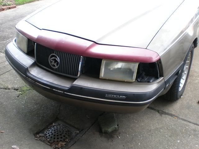

First, here's a pic of the new header panel. Not completely tightened all the way yet, and I have some of the lights out for cleaning and polishing.

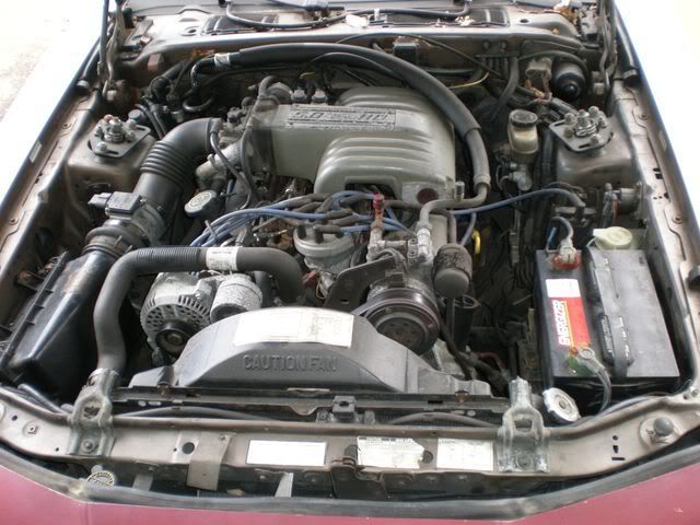

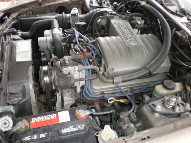

And here are a couple pics of the dirty engine compartment (with the hood out of the way).

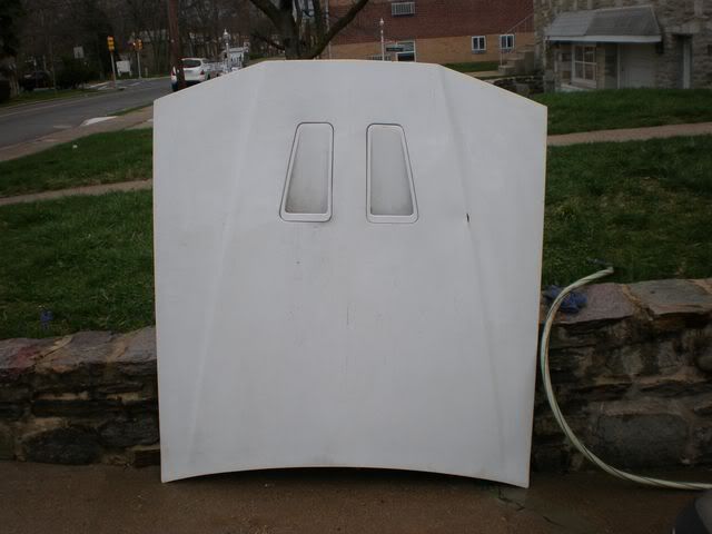

Here's the Turd-o-coupe hood.

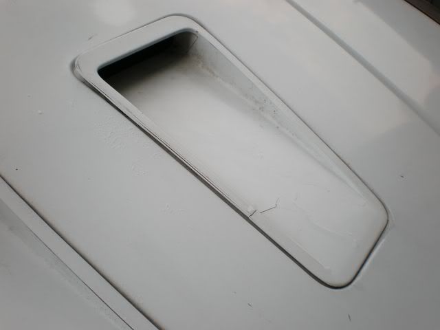

I think the A/C bracket hit the driver's side scoop.
Check it out...
Okay... I "think" I have an extra set of scoops somewhere. If not... um...

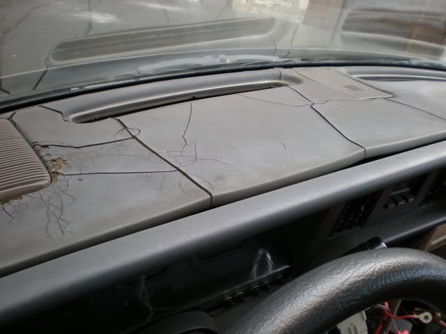

Couple more random pics.
Severely cracked dash, soon to be DashCapped!!!

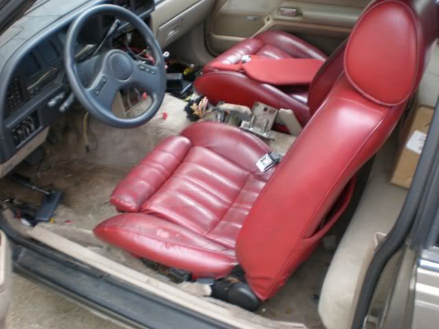

Buckets seats temporarily in place... with random tools strewn about.

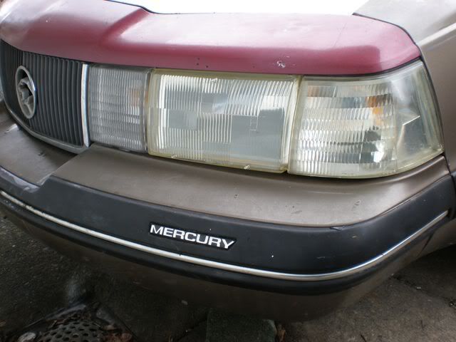

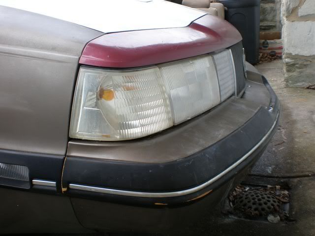

Removed the cracked hood scoop today and saw that it wasn't that bad. Patched the crack up, letting it dry now. Took apart my corner lights and removed the orange reflector. Epoxied them back together, and now I have clear corner lights. Put all the lights back in the header panel, adjusted the hood, and everything looks good! Waiting for the filler to dry, then do some sanding on the scoop. Also have to grind down the top hump in the A/C bracket so this doesn't happen again. Lots of minor clean up today in between the things mentioned. I'll probably wait until the carpet gets here this week before I do anything else major.

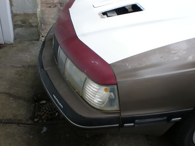

Clear corner light pics.

I can't wait to see that thing all finished and painted up...those seats seem vaguely familiar...lol.
For what it's worth, the same thing happened to me with the T/C hood...I ground that A/C bracket down to the bolt head pretty much...still had problems.  There is but one proper solution.....
A SET OF CHUCK'S POLY MOUNTS...best  things since sliced bread...a $20 poly trans mount would probably help also...I believe they are identical to the Mustang AOD tranny mounts.

Quote from: Sick88Tbird;214200
Y'know, as soon as I closed the hood and that scoop cracked I remembered you telling me that!
D'oh!

Oh Man,I forgot about the a/c to scoop clearance issue.I'm about to install all of the a/c stuff in mine and do away with the a/c delete.Thanks for the reminder.
Project - The Bat in The Cat
be sure to check. my hood fit fine, stuck of peice of clay on the bracket, closed the hood, didnt even begin to touch. i guess its a 50/50 shot. probably has alot to do with my car havin 200,xxx miles and worn out motor mounts sagging the engine down. but check before you stert hacking up your brackets.

Can't tell you how stupid I felt. I heard about the clearance problems before, and Don just reminded me about it a few weeks ago, and yet I forgot about it!
To top it all off, I was planning on taking the bracket off and grinding it down when I replace the A/C compressor with the one I just got from Bob, and it STILL slipped my mind when I was changing the hood.

The side markers look nice without the yellow insert.  Keep it going!
