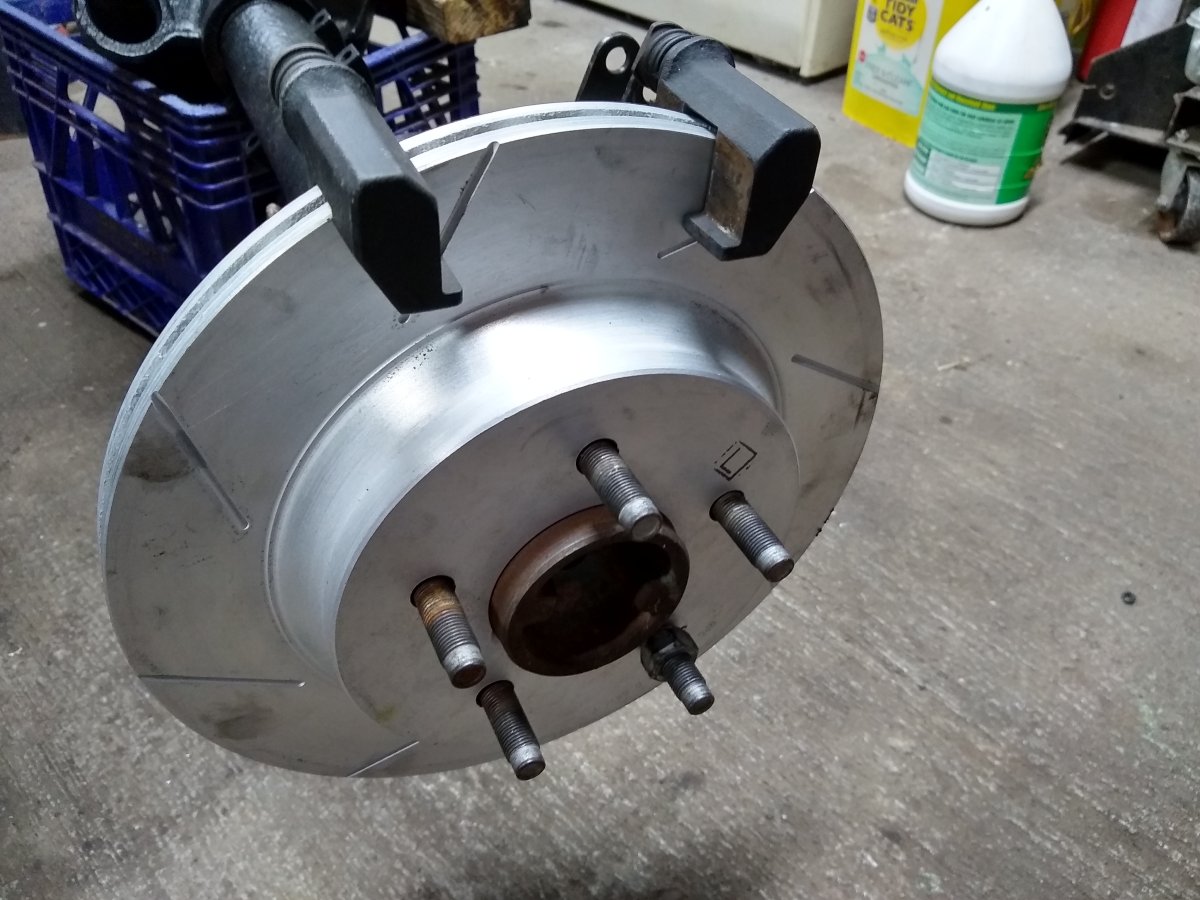

From there I try and bolt the caliper slider brackets on and find them hitting the rotor, on opposite sides.
Looking closer...
The hell?!? Yes, the caliper mounting brackets are bent. Both are bent in mirrored images of each other. It's hard to get a picture of, but you can for sure see it when you look at them when unbolted from the axle.
I'm going to see if I can tweak them back in line. If not, I guess I'll need to come up with another set.
I have no idea how they got bent like that. I honestly don't remember where I got them. I've probably had them longer than the brake rotors...

The bolt-on brackets for the calipers are both bent. Nothing welded here.

Are they the TC or SN95 brackets or custom?
Re: Chuck's '83 TBird
Reply #236
SN-95, for the Cobra brakes.

How did they get bent like that?
Reply #238
I couldn't tell you. The only thing that I can guess is whatever car they came from was hammered pretty hard.
I spent some time today massaging the brackets with a 20-ton press.
Got both sides straight again.
I may add some thin shim washers between the slider brackets and the axle mounts,just to center things up a little better, but at least the twist is gone.
